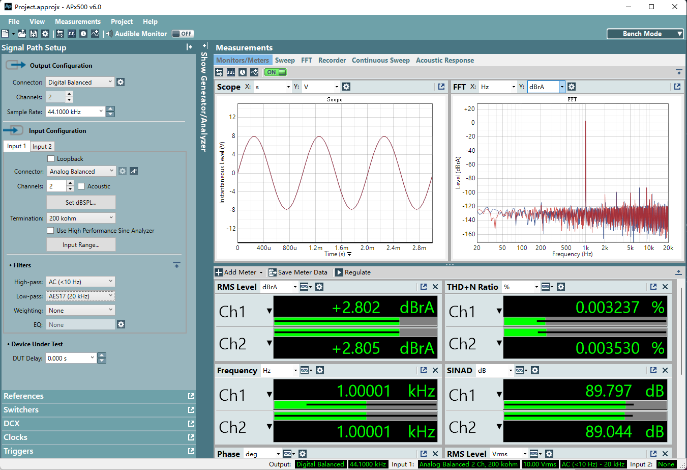

I emailed Gustard about the poor DSD-Direct measurements and got this reply back.
The circuit of the DSD direct part. The measurement result is floating.
Differences in SDM modulation types can lead to differences in results.
If you have played HQPLAYER, you will find that there are many options for upsampling to DSD
The following test pattern is to use foobar2000 software to play back the DSD test track
The test track is: 1khz sine wave 88.2khz PCM sampling rate, converted to DSD 5.64Mhz by saracon software
It does not look that good, but at least a lot better than the Direct DSD measurements done by L7Audiolab. I guess @jussi_laako can make more sense of this than I can ![]()
The fifth measurement picture is with DSD input and DSD direct enabled, see https://www.l7audiolab.com/f/gustard-r26/
It looks pretty horrible but I wonder how much better it can become with HQPlayer
The PCM measurements look pretty decent considering it’s an R2R DAC.
