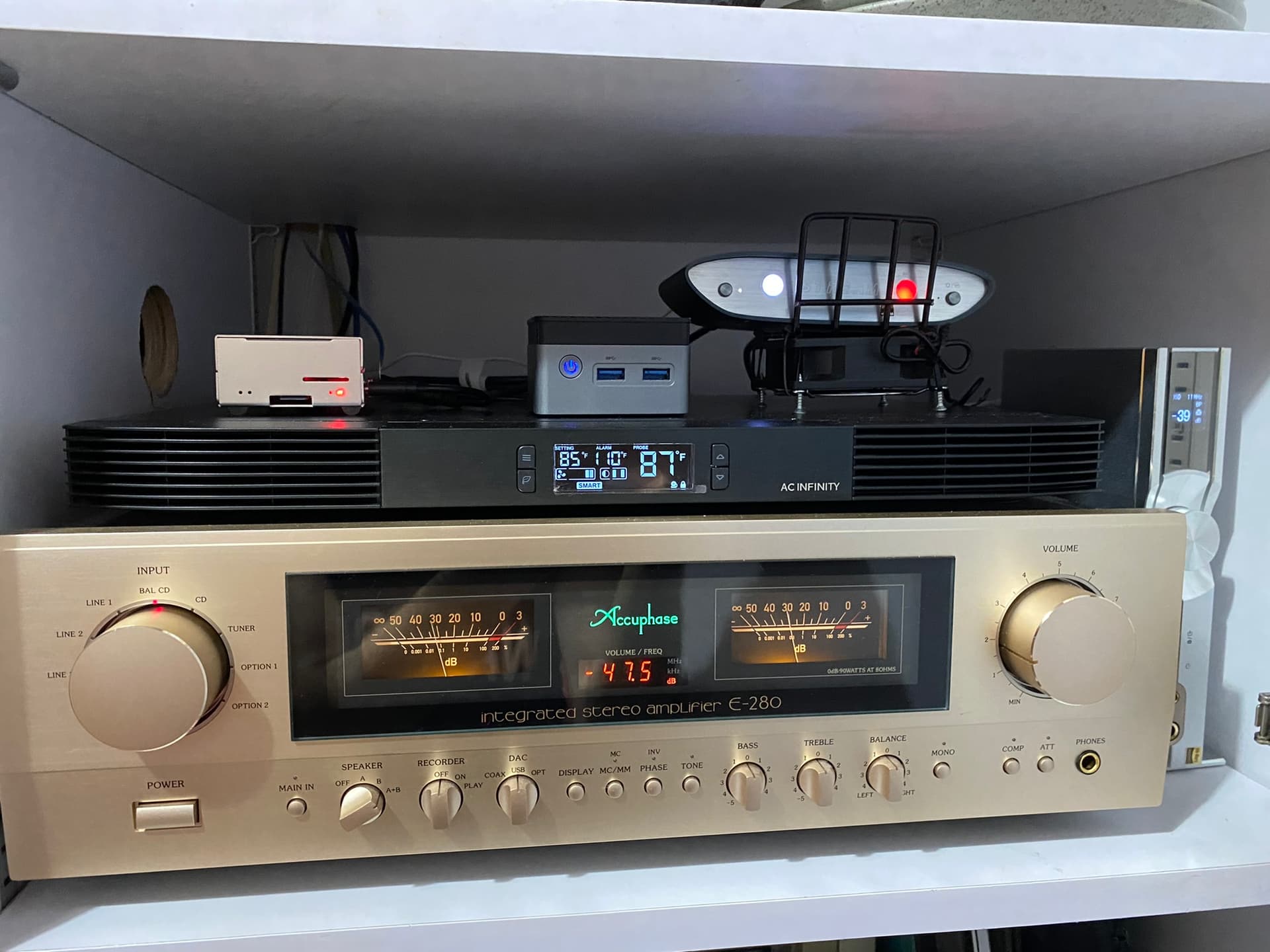

I totally agree, I actually have both devices, but now since I’ve upgraded to a dedicated hqplayer desktop mini to feed DSD512x48 to my NEO iDSD I had to drop the Zen Streamer
I have to say the ZS is not bad performing DSD256. But the Rpi4 NAA is more solid detecting the DAC when you turn it off/on or just connect on the fly. Unlike ZS needs to see the DAC on before you turn it on, otherwise you need to go to the app and select it on the source menu.

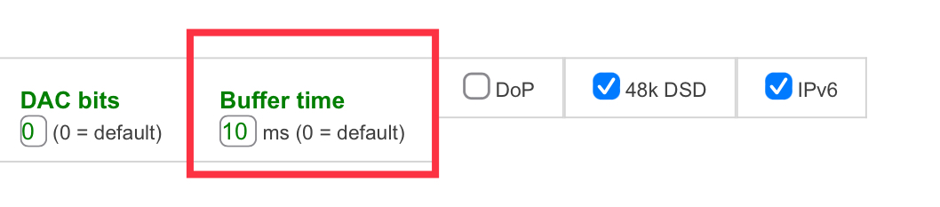

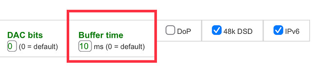

I had a Gustard X16 working off an embedded NAA in a SOtM SMS-200 Neo. Not an R2R ladder DAC (ESS) but sounded great. Problem was it was really unstable. Plagued with drop-outs. Couldn’t get to the bottom of it and eventually just abandoned it.
I would be interested in any feedback concerning the stability of the R26 with embedded NAA.
If you still have your SOtM sMS200 Neo which I own too the solution I could find was to set the Buffer time to 10ms in HQPlayer (embedded) and everything works fine

I still have the SOtM but I don’t remember being able to set the buffer time thru Eunhasu. Where did you get your screen shot from?
I did try a lot of buffer settings on HQPlayer. I cannot remember now if I specifically set 10ms but I can try as a last throw of the dice.
It is from HQPlayer embedded settings, there is nothing to set in eunhasu
Ok. That I never tried. So it is possible to access the embedded NAA directly without going through eunhasu? How do you do that?
No. There is nothing to set in NAA. Just set Buffer time to 10ms in HQPlayer embedded Network audio backend section. I’m using HQP embedded but I’m sure there is an equivalent setting in HQPlayer Desktop
