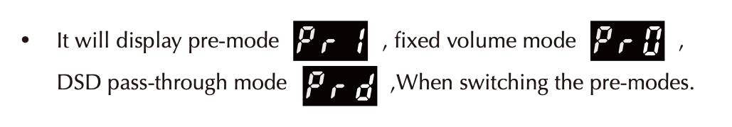

SMSL D-6 running in ‘DSD Direct Mode’ of its dual AKM4493S chips
Doesn’t support 48k based DSD rates, so need to fix HQPlayer output to DSD256x44.1k

Currently using the RME ADI-2 as an “input” into HQPlayer - WiiM Mini streamer TOSlink output for Tidal Connect, bit perfect Amazon Music UHD, Airplay 2, Spotify Connect, all goes through HQPlayer.
Bit perfect with auto sample rate switching.
But you need to fix HQPlayer output to DSD256x44.1k fixed rate - it won’t work with DSD256x48k
And using the remote control switch to “Prd” mode, which is the DSD Direct mode.

I got a firmware update from SMSL that fixed the DSD512 issue.
So I can recommended setting HQPlayer output to fixed DSD512x44.1k with SMSL D-6 (not DSD512x48k)
It works fine in native DSD512 with lowlatency Ubuntu 5.15 kernel - and fine with NAA OS image
