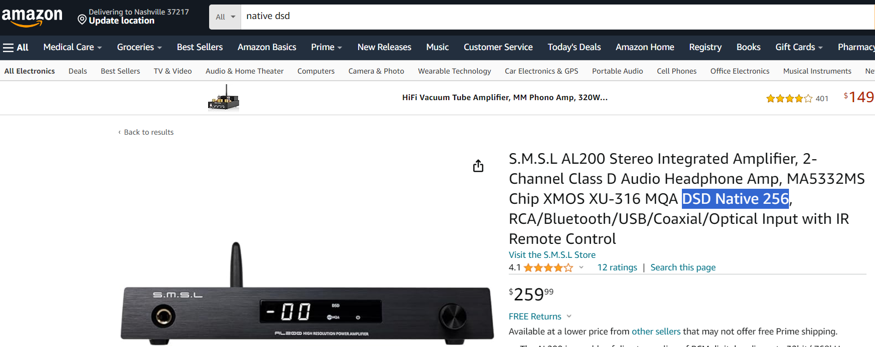

Totally agreed but the problem is in the DAC makers’ marketing materials.
They use the term “Support Native DSD” to indicate their DACs support raw DSD input (due to historicial reason?). Nowadays, I think there is no DAC that does not “support native DSD”
In this case, we should also cover non-DSD Direct DACs. Correct?
