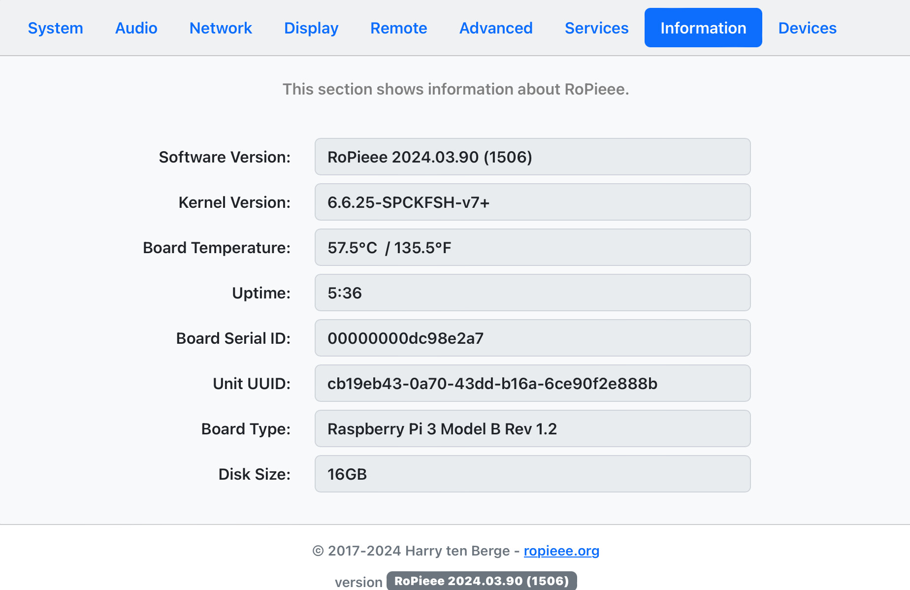

All good here with:
RoPieee 2024.03.90 (1506) [beta]
Hardware: Raspberry Pi 3 Model B Plus Rev 1.3
Network: wired ethernet
Audio: Orchard Audio PecanPi HAT
Display: No
Remote: No
Disk size: 16GB
Board temp: 50,5 C (+5 C from previous)
Great work Harry!
