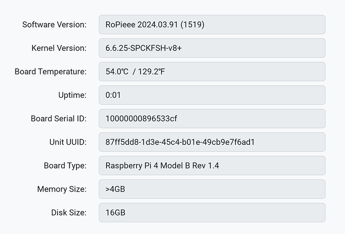

clicked install button to apply latest beta (2024.03.92 build 1528)
after reboot, it doesn’t look like the beta applied successfully … device still running prior beta (2024.03.91 build 1519) … and my audio device has disappeared (Allo DigiOne HAT … still shows as selected in RoPieee web interface, but it’s not enabled/available)
feedback 691b06a5dad44f27
device details …
Thanks for your feedback. I see what went wrong.
You can try again if you want to, I’ve got enough info.
thanks, will try again in a bit
(assume i need to wait a while for update to download again etc)
