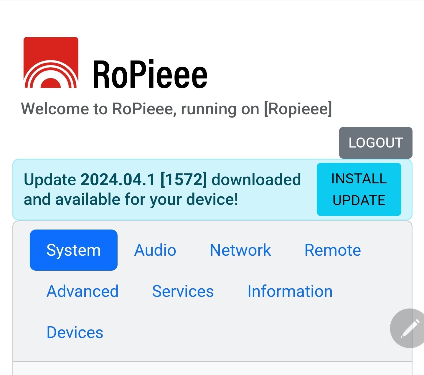

@spockfish Hi Harry, today I see new update but with lower number than I have.
Actually I have RoPieee 2024.04.1 (1577).
Should I revert to v. 1572?
You probably switched channels.
Again, update channnels are totally separated. If you switch the latest available version in that channel will be pulled in.
