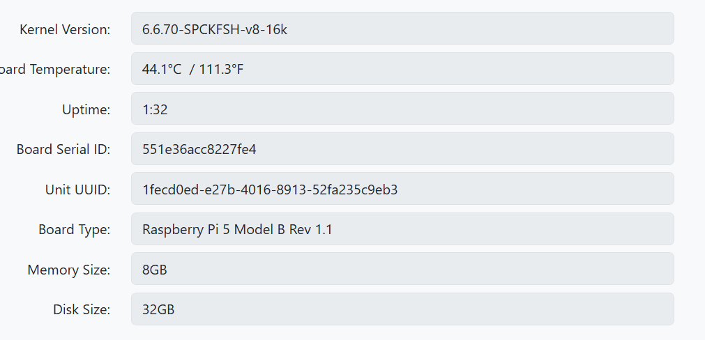

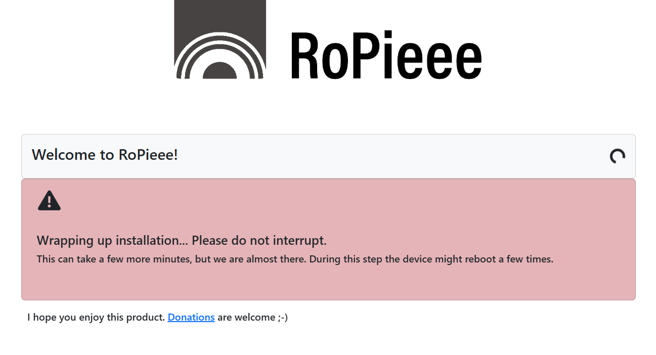

Reinstalled beta on the Pi5 and display 2 and it is stuck on the “Wrapping Up Installation” page.

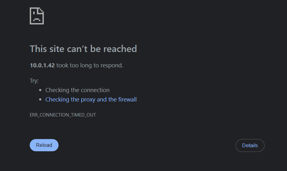

Just open a new browser tab and navigate to the device.

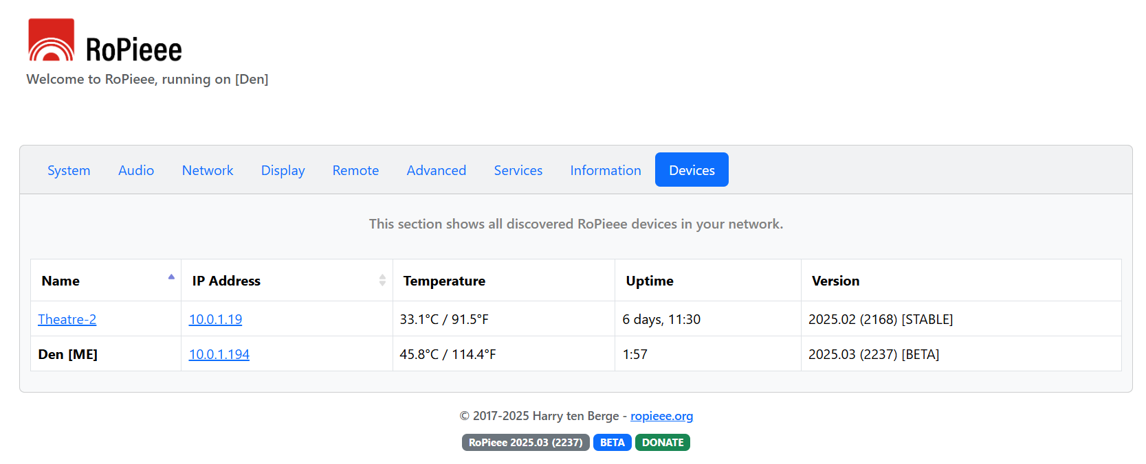

I have tried, but it doesn’t seem to be appearing. Even when I go to the Pi 4 IP address, I don’t see it listed under devices. The Pi5 and Display 2 are on a zone labeled Studio.
Did it work rifht after a fresh install?
I haven’t gotten it to work on the Pi5 and Display 2. I installed it upon release, froze on installation. Reflashed, froze on installation of beta again. Pi4 and Display 1 are working as intended with Beta 2025.03
But forget about the screen for a moment. Are you able to install a stable version to this Pi 5?
Yes. I can install a stable version, and it works fine. It is when I try and install beta, it freezes on the installation phase.
