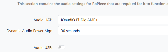

Hey Harry, my first issue with a beta in quite a while.
Applied to two, one working fine, the other isn’t detecting the DAC anymore. Configured as previously, but not showing up in Roon.
Naturally I’ve rebooted it again post install, but no change.
Feedback 0378f1ad26e3a9a9
I also just tried turning off dynamic audio power management but no change post-reboot.

audio device (hat) not showing up after update or subsequent reboot
pi4 model b rev1.4, 8gb memory, 16gb storage, build 2431
wifi, no display, no remote
allo digione spdif hat
roon, plexamp, airplay2
feedback 5dc9f1da4cd4c8ff
hmmmm… it seems that all HATs fail.
It’s good that I’ve got a small holiday :wink:
My successful unit was USB. Only the IQaudio HAT failing.

Hi Harry,
given that I’m using a HAT as well and thus Roon can’t see my RoPieee anymore, I tried to change to the stable channel but this doesn’t seem to work either (though I sure I’ve successfully used this to switch between stable and beta in the past).
After I confirm the config change and reboot I’m still on the same broken Beta release…

This fixes the “HAT problem” that unfortunately popped up.
