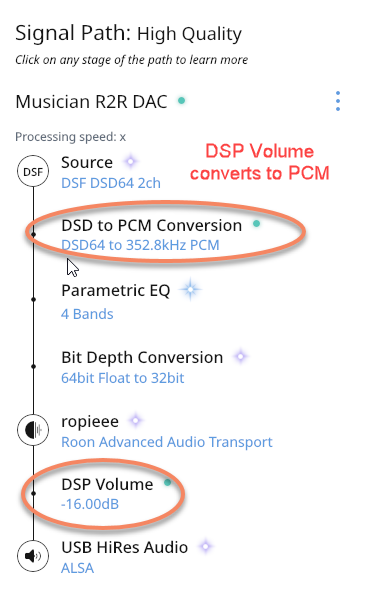

[I edited this to include a screen of my signal path with DSP Volume engaged]
So I’ve now had Roon running for 3 months, and I love it. What I don’t like is how I have to control volume in my setup.
I run Roon Core on a powerful Windows machine with a Ropieeee Roon Endpoint running into my dac. I use the Parametric EQ DSP for speaker correction, so I have DSP running all the time.
My dac does not have built in volume control, and feeds directly into my amp. What I am trying to achieve is the simplest/purest signal path, which I am sure is the goal of many others with high quality Roon systems.
The best path (IMHO) would not include analog attenuation, or an additional step of digital attenuation in the endpoint, or even further on in the dac. A Roon Ropieee endpoint’s digital attenuation is not very high quality. However, since I am already using the Roon DSP engine, adding in a volume control within the DSP does not add in any degradation to the signal, it’s already being processed in this step, it’s just an additional calculation at 64 bits, and practically no bits are being lost.
I currently adjust volume by using the Headroom Management in the DSP and sometimes by adjusting the level of the Parametric EQ. But the Headroom Management only attenuates to 30db. The sound is amazing this way. This works ok for me because I am primarily controlling Roon from my Windows Desktop, and I don’t adjust volume all that frequently. Here is a view of my signal path with DSP engaged, note that it is also not bit perfect because of the DSP.
So, what I’d love would be a Filter or something in the DSP that does a level control, and optimally mapped to the volume slider in Roon. This would provide the easiest and highest quality digital attenuation Roon can offer (without taking into consideration what’s happening in a DAC etc). And this attenuation would probably be superior in fact to the digital attenuation that happens inside of most dacs.

I actually chatted with Roon support about this. See this signal path, the DSP Volume happens after it has gone to the endpoint and before the DAC. My Dac does not have volume control.

If it’s the same code in the endpoint for volume leveling, then you are changing the signal to 64 bit floating point, applying the volume leveling, then taking it down to the signals resolution once again? So it happens twice in this scenario (in the Core & endpoint)? Am I describing it right? So a 16/44 file won’t get volume leveling applied while it’s 16 bit, correct?
I am using DSP for speaker EQ for an open baffle single driver system, and my EQ is mostly additive. I need to trim the signal with headroom management or the EQ filter. So volume leveling is already happening in my signal. Adding in one volume leveling step in the DSP, while its in a 64 bit state with your high quality code, is surely better than adding in an analog volume control after the dac.

BUT I hit a big snag on the DSD files. I was listening to the difference and it was bigger, and I kept saying to myself, this sounds more like PCM. After a few tries I looked at my dac and DSD was not showing, it was PCM! Looking at the signal path, it was indeed converting it to PCM at the beginning of the chain! I wasn’t expecting this, and I can’t use DSP Volume in this scenario, I listen to a lot of DSD. Could this just be unique to my setup? I am including screenshots.

So I feel like I’ve come full circle to my original post. Because the solution presented, DSP Volume, converts DSD signals to PCM. Having a pure DSD signal path is a requirement for me, as I listen to a lot of DSD (currently 110 frequently played albums!), and I’ve invested in hardware that supports it.
