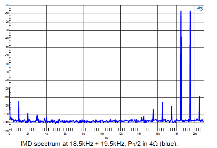

How would they? A physicist among us could give an answer.
Intermodulation distorsion can produce audible components at lower frequencies.

Or you could just do some research… Google is your frenemy… There's life above 20 kilohertz! A survey of musical instrument spectra to 102.4 kHz
or listen to Rupert Neve discussing life above 20kHz… And you always wondered why his consoles sounded so good… Lecture at CRAS 2001… Rupert Neve Lecture at CRAS 2001 - YouTube
I roughly understand the concept. Here is an IMD measurement of one of my amps (double mono Hypex 250 MP). Do you suggest that IMD created by the high frequency 18.5 khz signal are audible at -115 dB?
