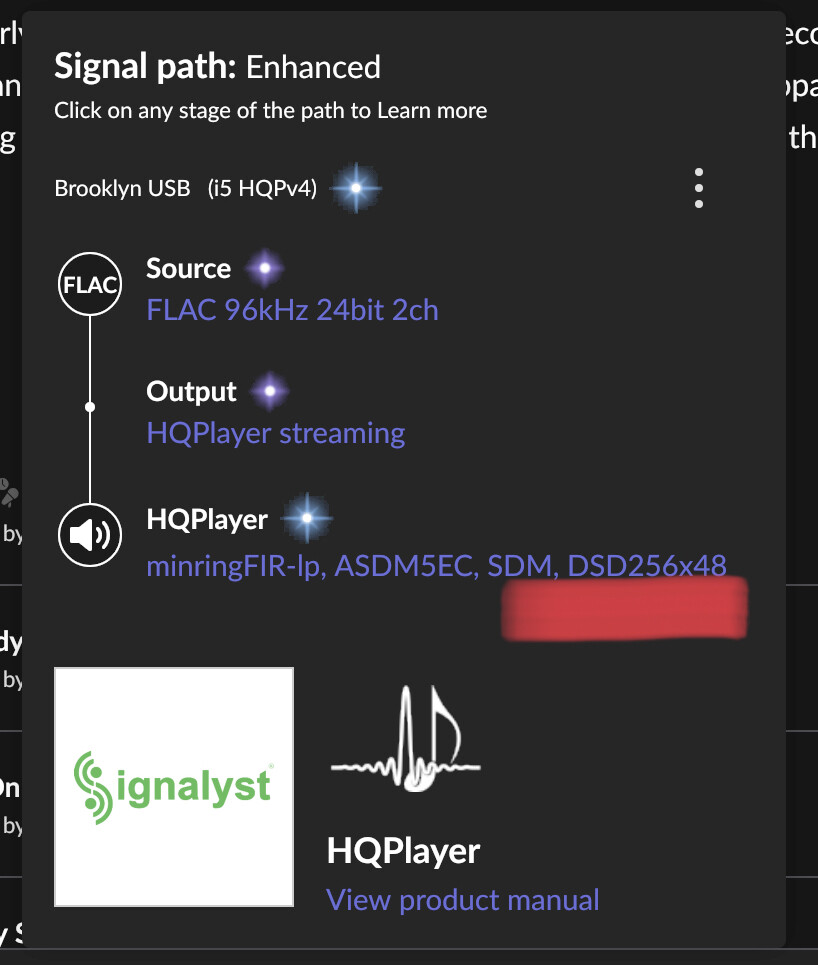

I’m using USB input as I thought only USB input supported DSD256 rates. As you can see the DAC doesn’t seem to like DSD256x48.
All works as expected on a 44.1k source with DSD256.
DSD256x48 is a different story… No lock on dac from 48k source. Files plays at slow speed with noise.
