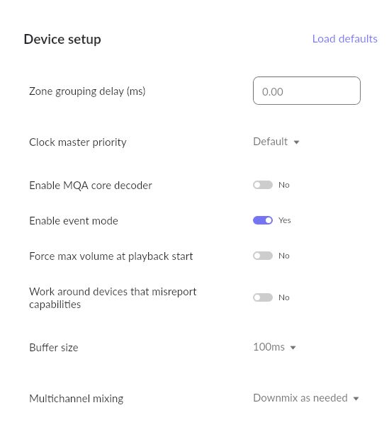

My bad. That’s not an option for any of my audio devices. Hopefully it will help reduce the problems you’ve been experiencing.
Thats just for a connected DAC its not giving the streams a larger buffer to cache or anything to stop drop outs based on network latency. But if thats what you wanted.
