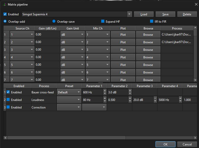

I see the option for crossfeed but the EQ is unclear.

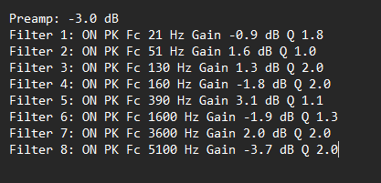

I took my parametric EQ txt file and uploaded it into source channel 1 & 2 by clicking “browse” next to the respective row. This doesnt feel right? Attached is the screenshots to show what I have setup.

Yes, that’s correct. You can save different settings as matrix profiles which you can then switch on the fly as necessary. And for example for comparison purposes.
Please remember that every time you browse and select a file for matrix, it get’s appended to the process list. So if you’d like to replace a file with another one, please remember to remove the previous entry from the “Process” field .

For the crossfeed, the preset overwrites the parameter 1 and 2 section in the same row right?
Parameter 1 and 2 only come into play if I select custom preset?
Yes, that’s correct. Those parameters only apply to custom one.
