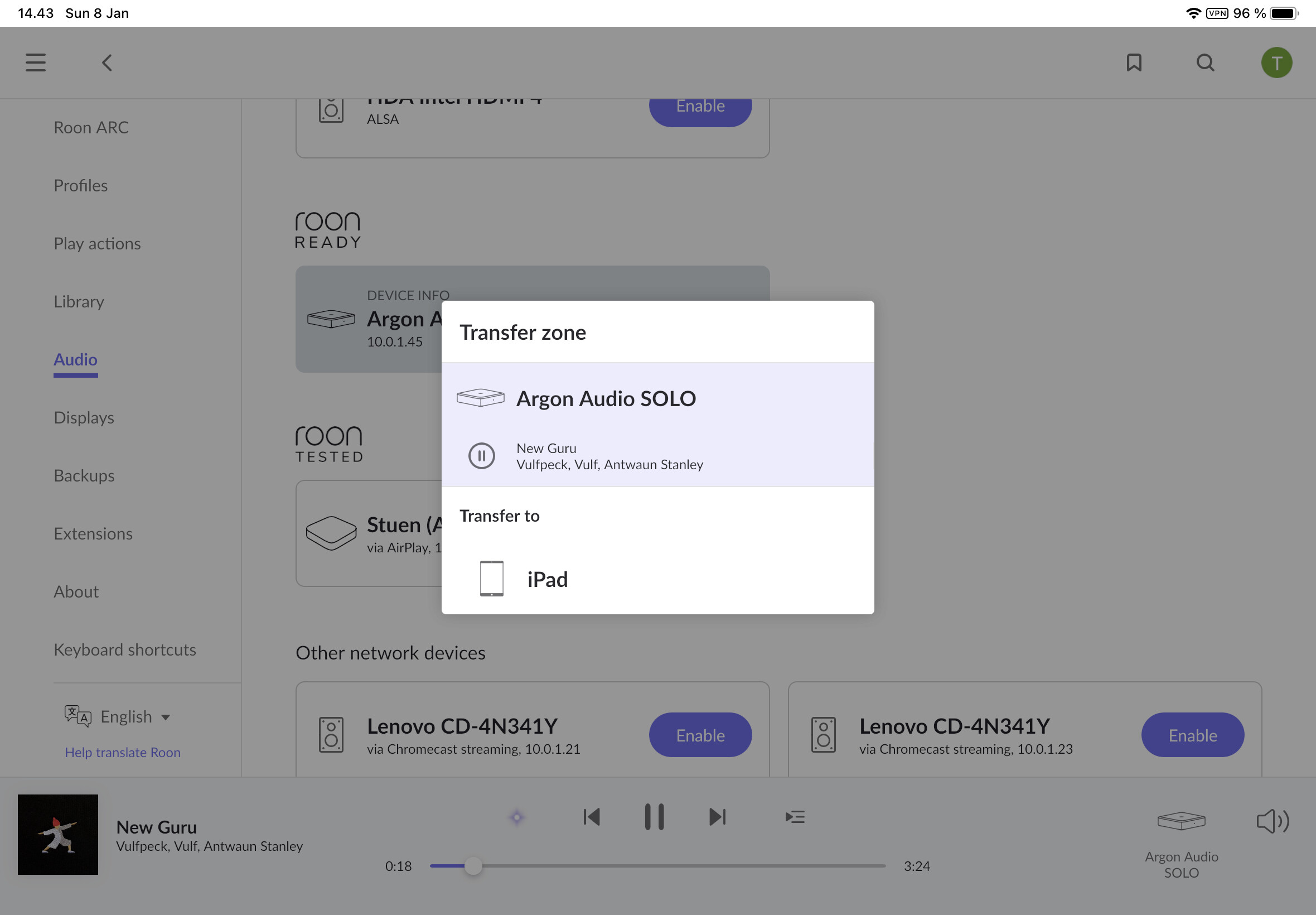

Bought the NUC today and installed ROCK. It seems that everything works, but everyday use has to confirm that. ARC can connect, and my router is set to give the ROCK the same/static IP via NIC MAC address.
Playback works on my Ipad and on my Argon SOLO. And it only uses around 7W/h (no DSP in one zone). I think that’s actually a bit less than my Mac mini M1. I like
