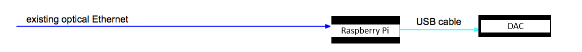

My idea was to run fiber optic cable from my ethernet switch with an sfp slot directly to a raspberry pi that would act as a NAA for my HQPlayer. DAC would be connected directly to the raspberry pi through USB.
This way my Roon core, hqplayer and raspberry pi NAA would all be isolated and connected through my local network.
My question is, is there anyway to connect fiber optic cable directly to the raspberry pi? I know i could use fiber media converter between the ethernet switch and raspberry pi to make it where ethernet would be going in to the raspberry pi but that defeats the purpose of the analog noise isolation.

Firstly, the Raspberry Pi does not have an SFP(+) connector so you would need to add a bridge device which in turn would be connected to the Pi by normal ethernet. Thus you are not really achieving anything.
Secondly, ethernet with CAT5(e) or CAT6(a) cables is already galvanically isolated so there is no point. You would only be increasing the link complexity and thus increasing the chances that it will fail.

You would need to go for PCIe SFP network interface connected to PI. I’m running simmilar setup with RPi5, but not with SFP, but rather dual-port server NIC from Intel.

It’s the best, most effective and economic solution to use a true USB isolator between the RPi and your DAC, of course!

Ethernet is galvanically (transformer) isolated at every interface unless you defeat it by using a shielded cable.

I know its a bit late, but I just received this in the post and have installed it: Pi 5 PCIe to M.2 & SFP Gigabit Ethernet Adapter, Supports 2280/2260/2242/2230 NVMe SSD, HAT+ Standar
It is working perfectly on my Pi 5
