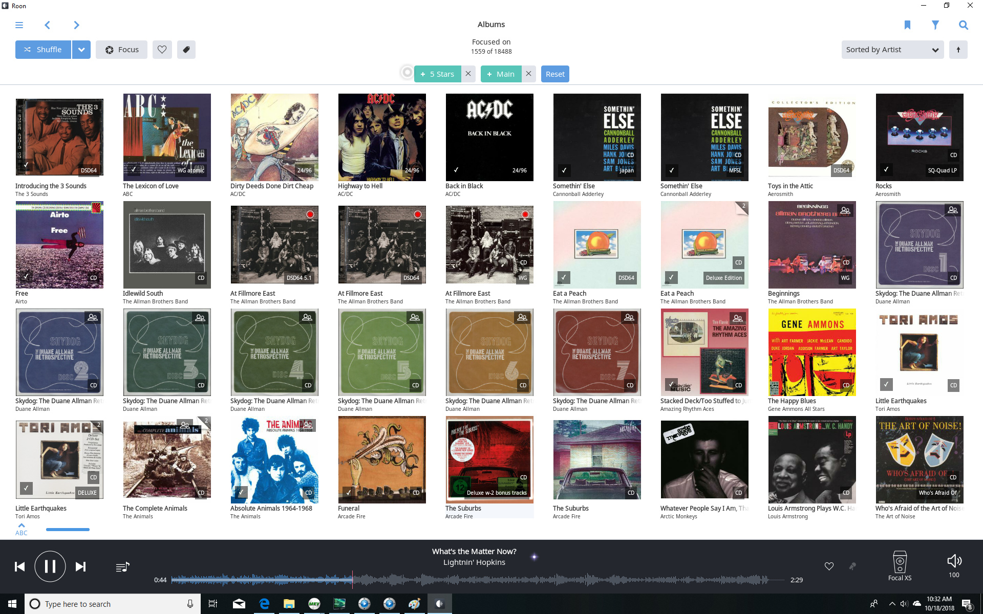

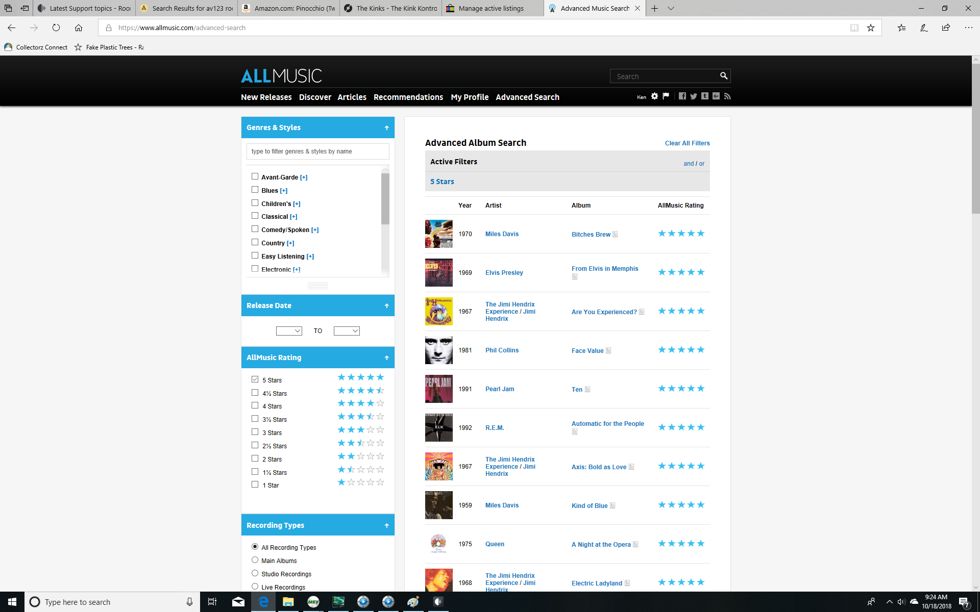

Can you search for 5-Star rated albums?
Here is how it looks in All Music Guide, can it be done in Roon?
Three lines top left of screen, select albums, select focus, onto the left side select rating, select 5*.
outstanding! Thanks!
I now see how I can sort on other things like just my multi-channel collection!
If you tap on either of the green tabs ‘Main’ and ‘5 Star’ they will go pink and you will see everything except those filters, focus is a very useful tool.

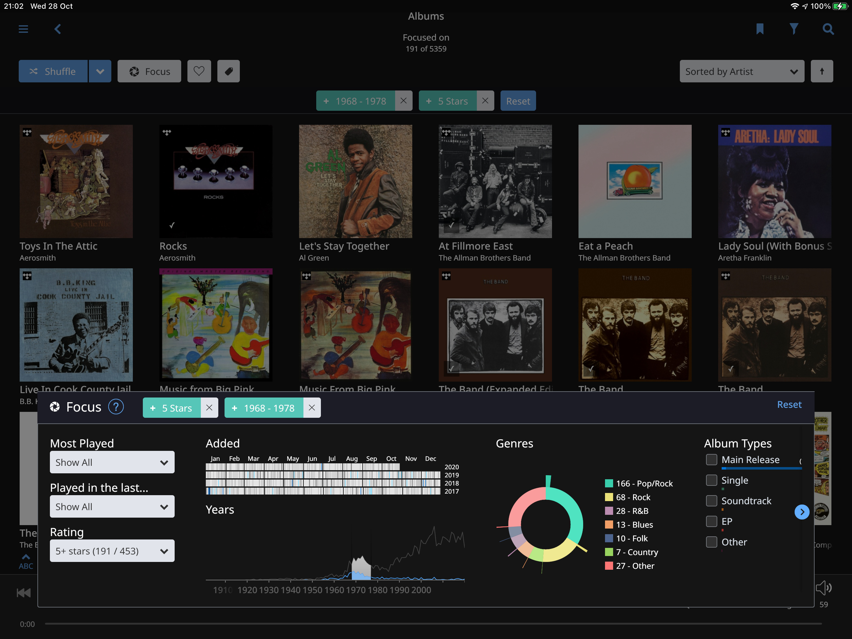

Does the star rating system that you can select in Focus include both our own ratings as well as AMGs?
I like the FOCUS button and use of exclude “pink” status.
Anyone know the answer to my question above?
I guess I could just mess around with it myself and figure it out, just never really paid attention to album ratings other than album reviews.
It includes both, your rating overrides the external rating.

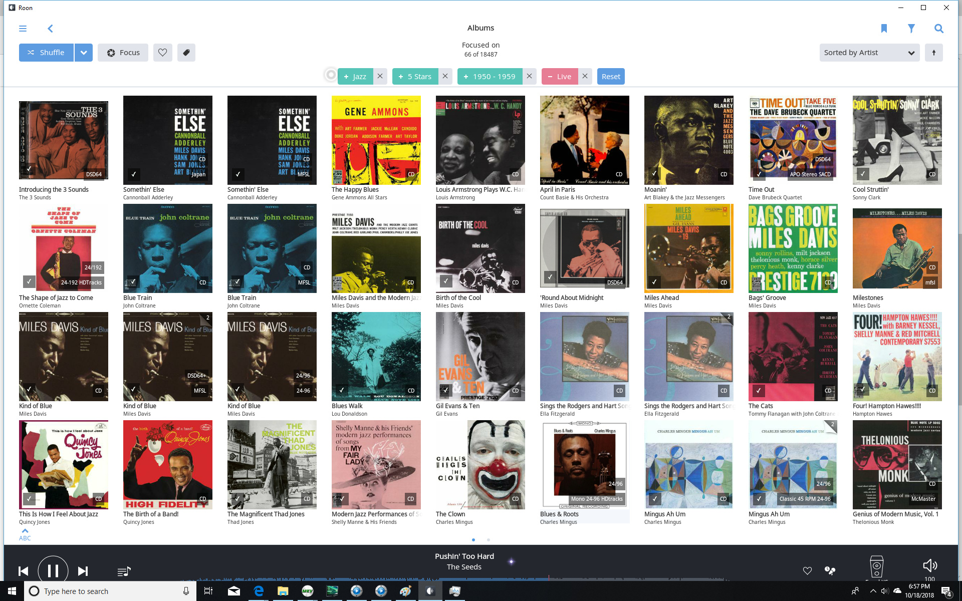

This sort of thing?
