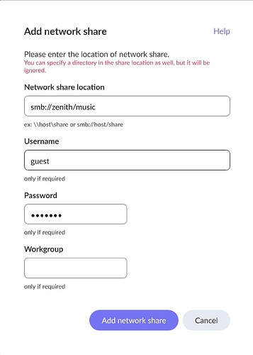

I’ve just installed Ubuntu and then Roon onto a new Beelink mini PC. Everything seems to be running normally except for when I try to add a network storage folder to Roon. The drive is a networked shared folder on an Innuos Zenith MkIII server and the odd thing is, is that I am able to access and see all the files on the drive in the Ubuntu file app, but Roon notes “You can specify a directory in the share location as well, but it will be ignored.” I also have a couple of Synology NASs and I can’t add then either, so it’s not just the Zenith. I can access my streaming service perfectly and in all other regards Roon is working normally.

Your screenshot is missing username and password as well as an error message. Can you try again with username and password and then share a screen of the window again, showing the error Roon displays as explanation why it could not mount the share please?
The red text, „You can specify…“ is not an error, it’s just informational. It means that only network shares can be mounted here, and you can’t directly mount folders that may exist on the host machine below the network share. This is normal.
What happens if you click the Add network share button?
Hmm. When I click on the Add network share button, it brings up the identical page again, complete with completed fields as they were. I have a number of network shared directories and folders on my home network, and all other devices have no trouble connecting to them. The //zenith/music shared folder has been my default storage folder for quite a while and is accessible from all the other devices including Roon server running on a windows 11 laptop. Why it should just this installation I cannot guess.

Yes, the form is identical. It doesn’t matter what I type in the fields, it comes back instantly with the page I just completed, complete with red message.
