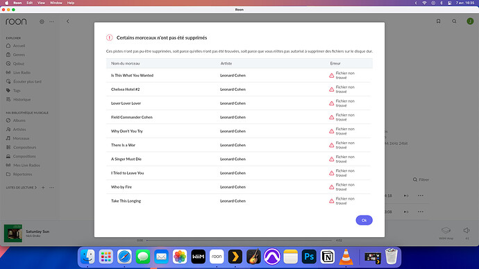

Can't delete an album
Some people had a similar issue in the past, and I don’t think there was a solution apart from an update from Roon. I can’t delete some albums, even if I restart the server.
Justin,
The dialogue in your post is saying that the tracks appear no longer to be in your library.
Did you (try to) delete them manually yourself?
If not, when do you get the message, a screenshot of which you post?

Yes, I deleted this album that comes from Qobuz in Roon. No matter what I do, the album remains in my library. I get this message the first time I try to delete the album (after a reboot). After that, even when I try to delete it, there’s absolutely no change.
