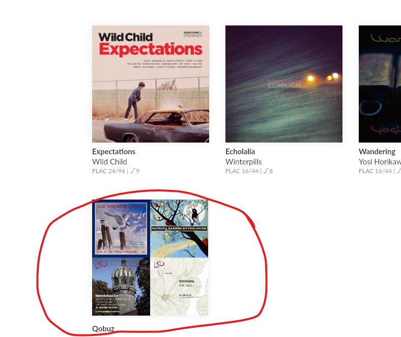

However, for some reason if I try to focus on the “Bandcamp” Tag then roon just shows me all of the albums! Focusing on any other Tag (for instance Qobuz) work just fine. But for some bizarre reason I cannot get Roon to focus on the Bandcamp Tag …

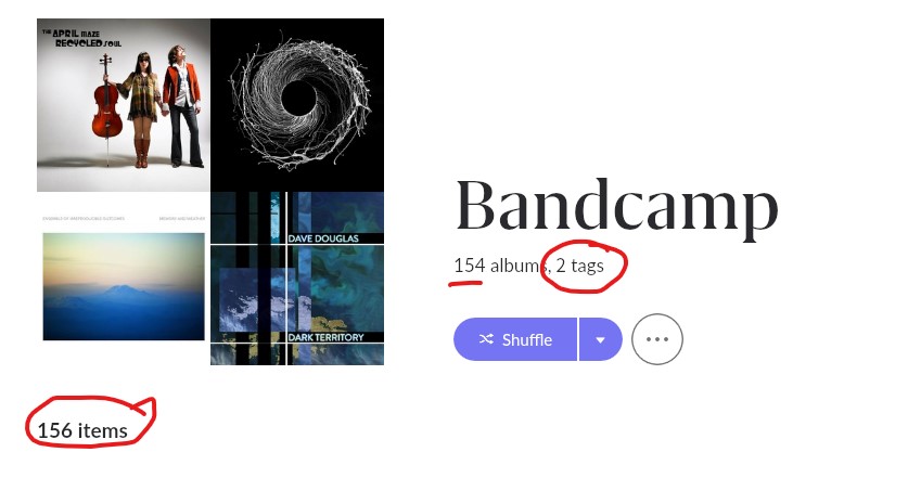

I think I found the culprit… when I went thru the Tag menu I could see the Albums tagged with “Bandcamp” appear correctly, but if I went thru the “Focus” menu it showed me other things… I noticed in the Tag the count of albums had “2 Tags” appended to it (see here)…
I then looked carefully and found out that somehow I had the “Qobuz” tag nested inside the “Bandcamp” tag (I did not even know that possible!)… When I removed the “Qobuz” tag from within the Bandcamp tag, things worked well.
