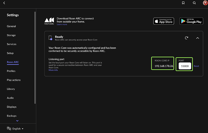

An option would be to to disable UPnP again and instead set up a manual port forwarding rule, using the IP address of the Core and the port number as they are displayed in Roon > Settings > Roon ARC. Do you know how to do that? It’s in the manual like here:

Will I need the core IP and is the port #, mine 12345, just a random # chosen or whatever you choose has to match in port forwarding?
Whatever Roon tells you in the ARC settings, use this in the rule:
(For background: Imagine the port number as a tag telling the router the door number in an apartment building. The traffic that the ARC app sends from the internet arrives at the building, this is the external IP address that your ISP provides for you. The traffic packets also carry a tag saying that it’s for door (port) 55000, as shown in the configuration in my screenshot above. So the router says “oh, 55000, this goes to the internal IP address of the Roon Core”. You could have other port numbers forwarded at the same time, e.g. for a game console using port 12345, and then if a packet arrives with the tag 12345 the router would go “oh, port 12345, that has to go to the PlayStation”. Note that 55000 is the port in my Roon, yours may differ)
By the way, in step 5 of the router manual, “5. Select the protocol, TCP, UDP or Both, indicated in your documentation”, use TCP
