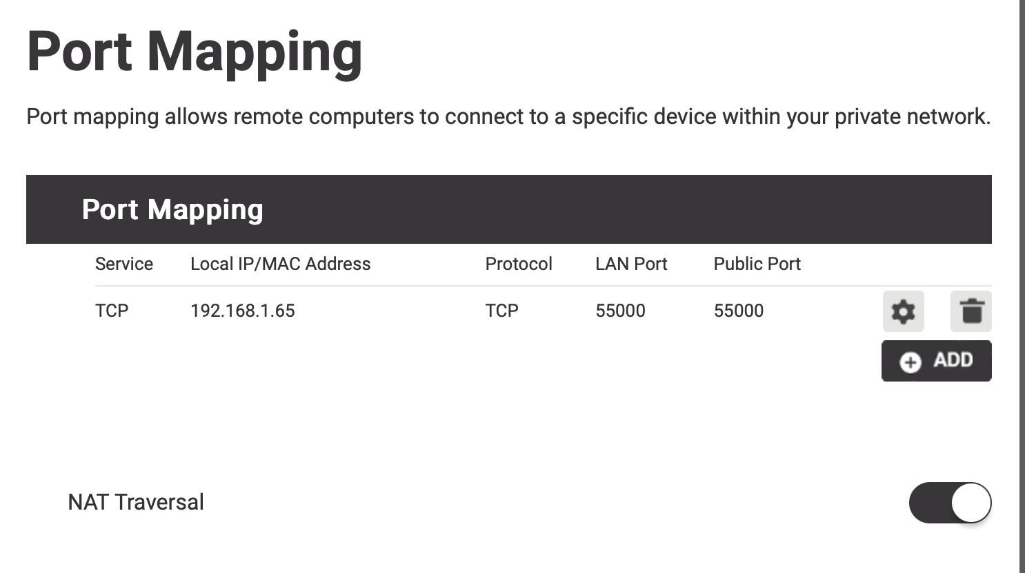

Then I added the port forwarding rule as recommended:
While I got different error messages during this process,
the current state is that I can’t see the server even from within the same network.

If you have a static ip address, and you have ellimated the use of multiple subnets (which you appear to have), then the only thing left to do is to configure port forwarding by either enabling uPnP support or creating an explicit port forwarding rule.
In your original post, you had uPnP enabled, and it appeared to have configured a port forwarding rule.
