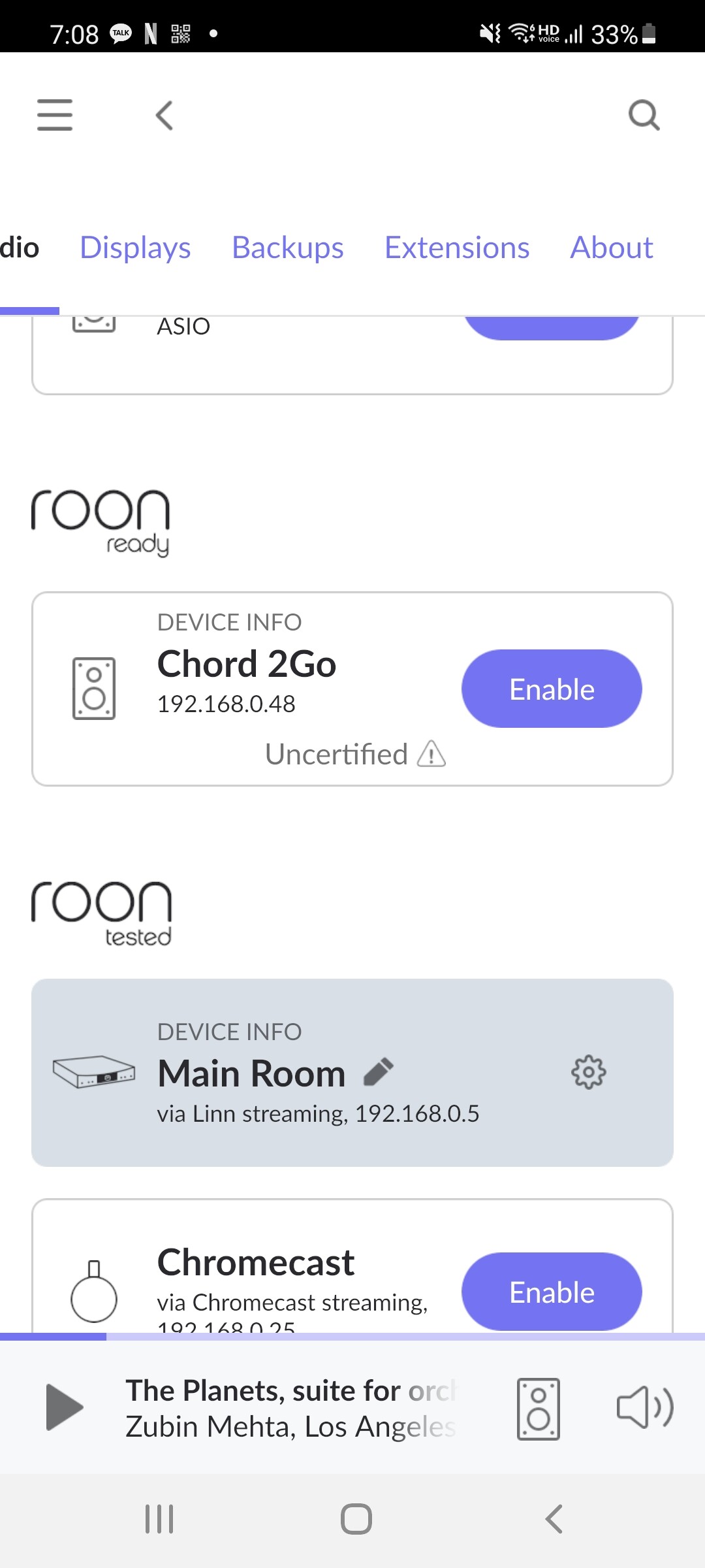

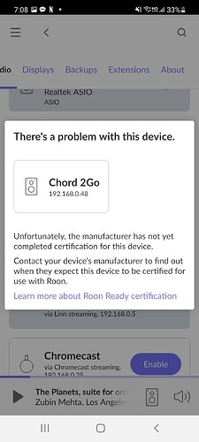

Hi, I’m using 2go with hugo2. I want to streem to 2go(hugo2) via roon. But as below…
I was reinstall a roon. :frowning:
Roon & 2go is same status.
What’s wrong?
Would you help me?

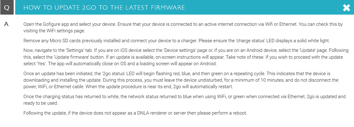

Make sure you run the latest firmware for 2Go.
Just checked mine to confirm the version numbers. Latest 2Go firmware is 1.0.3. With it, my 2Go+Hugo2 shows up on Roon as properly certified.
New firmware released today, ver 1.5.0. I’ve installed it and so far it works as expected. No issues with WiFi today, but it is to soon to pass any judgement on the new FW after just 4 hours of testing.
