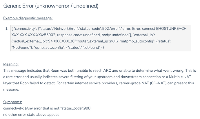

You mean the MultipleNatFound error? It would really help if you posted the “exact” port forwarding error message, so that there is no guessing. There is also more than one version of this message now. There is a copy button next to it and you can then paste it here
Some internet providers it’s not possible to go around this.

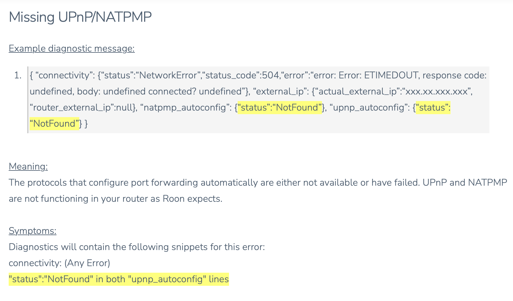

this has been the error I receive lately. ARC woorked fine for months and now recently this
“ipv4_connectivity”: {“status”:“NetworkError”,“status_code”:504,“error”:“error: Error: ETIMEDOUT, response code: undefined, body: undefined connected? undefined”},
“external_ip”: {“actual_external_ip”:“73.aaa.bbb.ccc”,“actual_external_ipv6”:“null”,“router_external_ip”:“null”},
“upnp_autoconfig”: {“status”:“NotFound”}

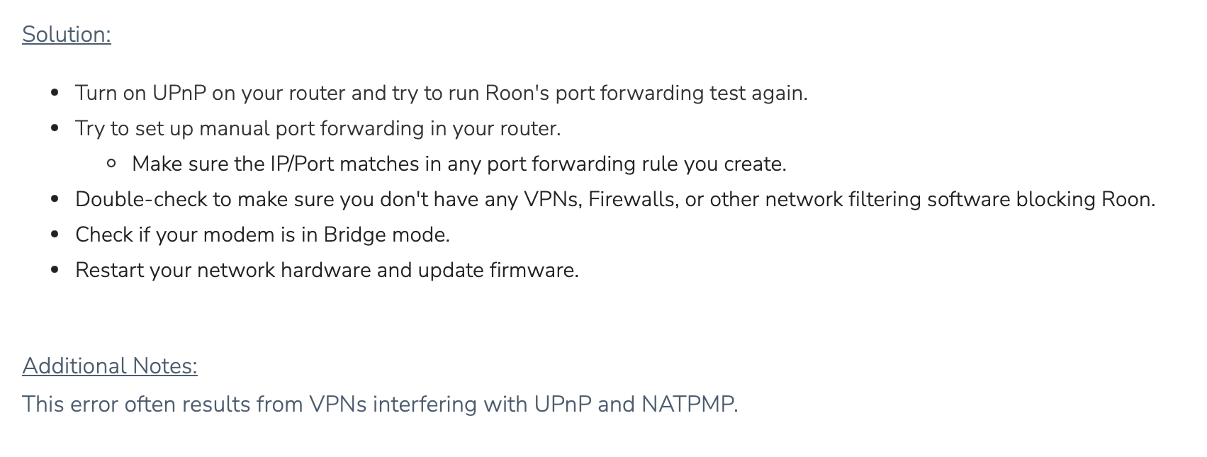

This simply looks like UPnP not being enabled:
From the help:
from:
Check in your router settings and enable UPnP if it isn’t. You can find the description here in the chapter 5. Make Xbox Online Games Run Smoothly by UPnP
in your router’s manual:
Tell us if this doesn’t work

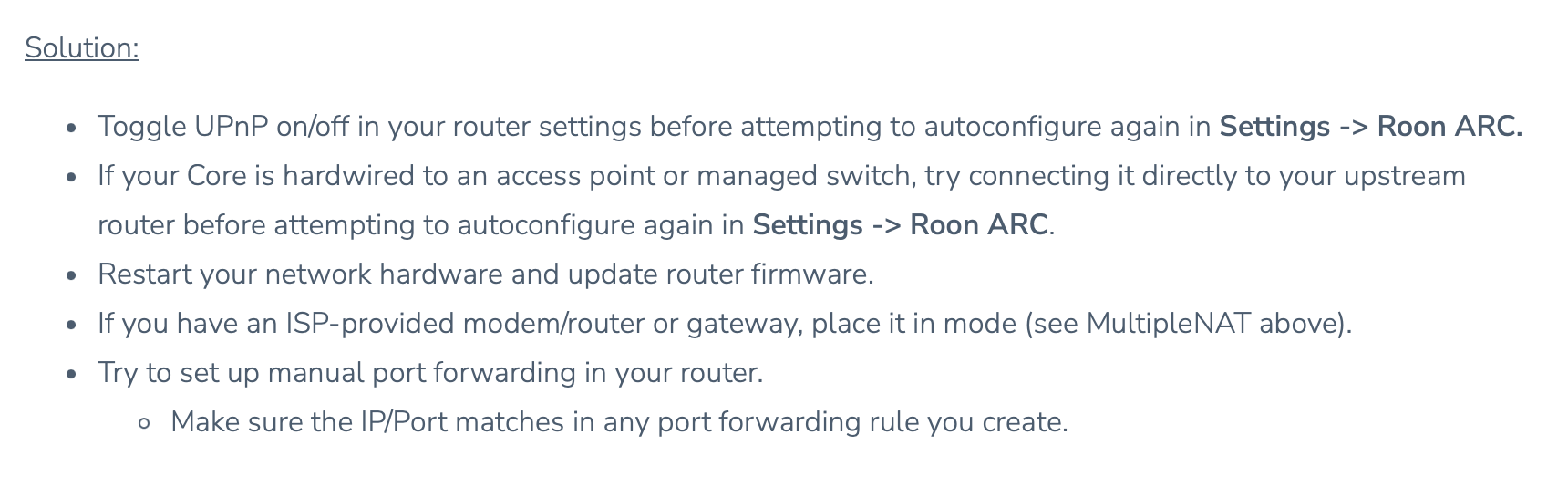

You hadn’t mentioned a separate gateway. In this, case, the port must be opened on the gateway as well, like you seem to have done. As this didn’t help, it might be this issue:
So try this:
