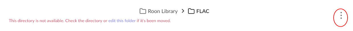

  • Disconnect the 6TB and 5TB drives from the network so that roon cannot see them
  • Turn on roon.
  • Map your new 8TB drive in roon.
  • You will see error messages’ in the storage locations in roon as roon cannot find your old 6TB and 5TB drives .

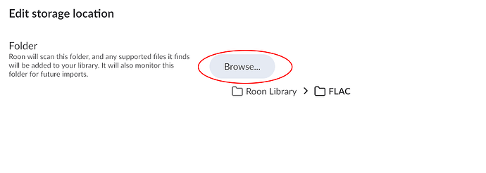

  • Just go to the three dots next to the errored file location and click:
  • Then edit the location to the new location
  • Its a lot of steps but it should all be rather painless.

At first it looked like I had problems as the album count escalated to well beyond what was there prerviously. Then the penny dropped that not only was Roon addressing files in the two new folders but was also looking at all albums in the new drive again and treating them as new ones. A check to storage settings showed I had inadvertently connected the drive as well as the two sub folders so that was easily remedied and hey presto, my halo reinstated - SUCCESS!! All previous editing on the 2 older drives, now successfully displayed via the newer single drive.
