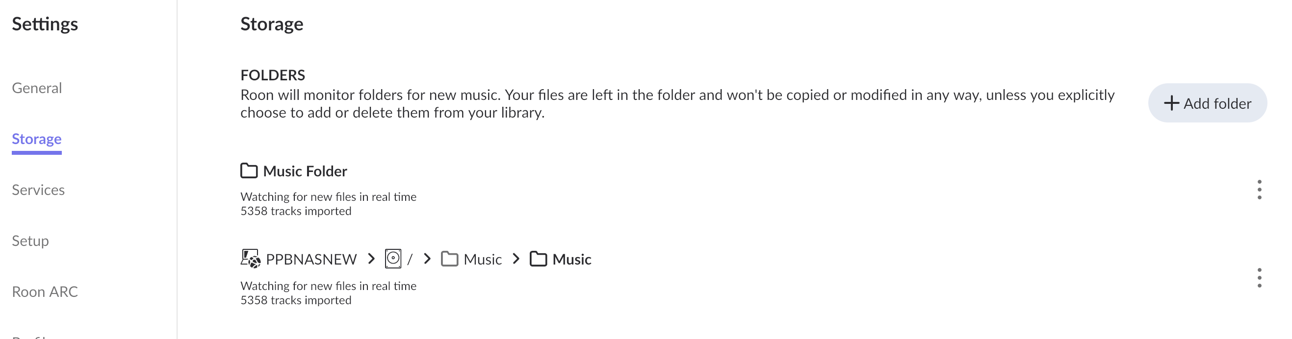

In Settings > Storages, you should see a folder named ´Music Folder´. As far as I understand, that one represents the second path, which inside the container is the :/Music folder structure. If it is enabled and showing no files found inside, the path most likely is wrong.
After restoring a backup and deleting the remnants of pre-docker paths, or SMB share paths in your case, according to my experience, roon usually finds the new path to the known files relatively quickly. My library is similar in size compared to yours (60K tracks, half of which are classical, and lots of huge FLACs) and CPU/QTS are the same, maybe it was 2 or 3 hours to recognize everything? Don´t remember precisely.

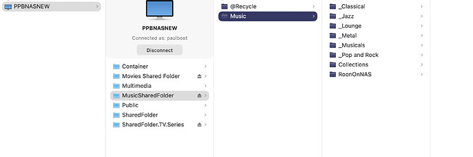

You might want to make sure the folder structure with the FLACs does NOT contain a zillion of other files, such as separated metadata files, pictures or deleted files (which tend to hide in the @Recycle subfolder, but through the container path, they are fully visible).
If you need assistance in creating a valid second share path for the docker container, feel free to share a screenshot of your top-level folder structure on all volumes containing music files.
Thanks for the quick reply, @Arindal , appreciate it.
Here is the screenshot of the storage area.

To your point on other files than FLAC, I’ve already removed (most) of those, and some of them I’d like to keep, but good point for checking.
Re valid second share path, see screenshot below.

As the number of identified tracks is identical in /Music folder (via Container share path) and SMB path, we might have a situation in which one and the same track is identified twofold, causing roon to have duplicates, struggling to identify them as ´your´ files, and slowing everything down.
I suggest to disable the second, the SMB parth, and see what happens in the /Music Folder.
You don´t need to delete the pre-docker paths as you seemingly have none. But you might want to check what happens if you keep the Music Folder permantently disabled (which means roon will get file data solely via SMB), or you need to delete the SMB storage path, preferably immediately after restoring a backup, so roon would recognize files in the main /Music Folder as the ones it already knows.
I assume you have defined the second share path for the container as:
/share/MusicSharedFolder/Music:/Music
am I correct? If this folder contains the /RoonOnNAS folder with the previous installation, you might face performance problems simply because you give roon the task to scan all the database files in this one, which together with legacy backups can exceed 100,000 files in number. I would move all folders containing lots of files, away from the music folder the container can see.
