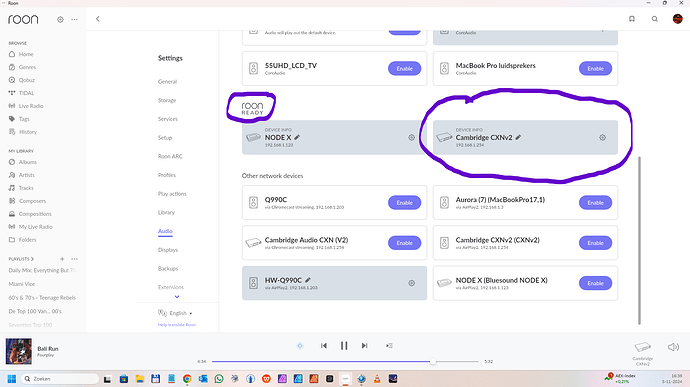

You should be using the Roon Ready version of your streamer. Select the audio settings for it.
and it will happily play up to 24/192 when streaming.

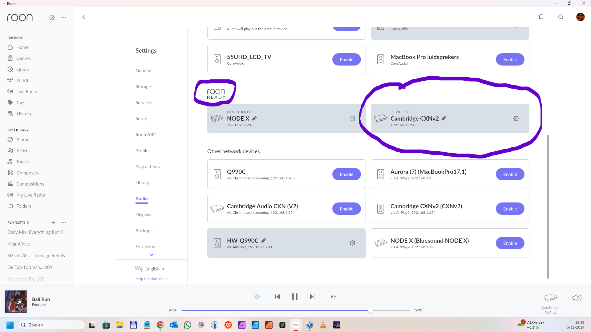

Try the Roon Ready version of your streamer in the audio settings. Roon will use its RAAT protocol then which will play back the music at the correct bit depth/bit rate.
Check the screenshots that I’ve posted earlier where to find it. And also check the Tidal settings in Roon if it set to max.
RAAT is short for Roon Advanced Audio Transport. It’s Roon’s own network protocol. And if a device is Roon Ready, like your Cambridge, it is the preferred way to play music in Roon. As RAAT is only limited to what your streamer can handle.

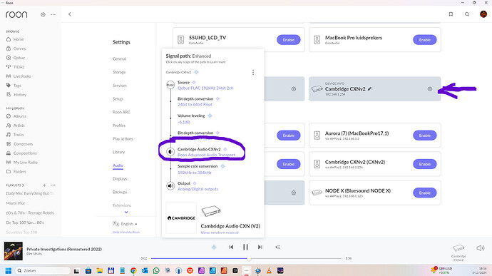

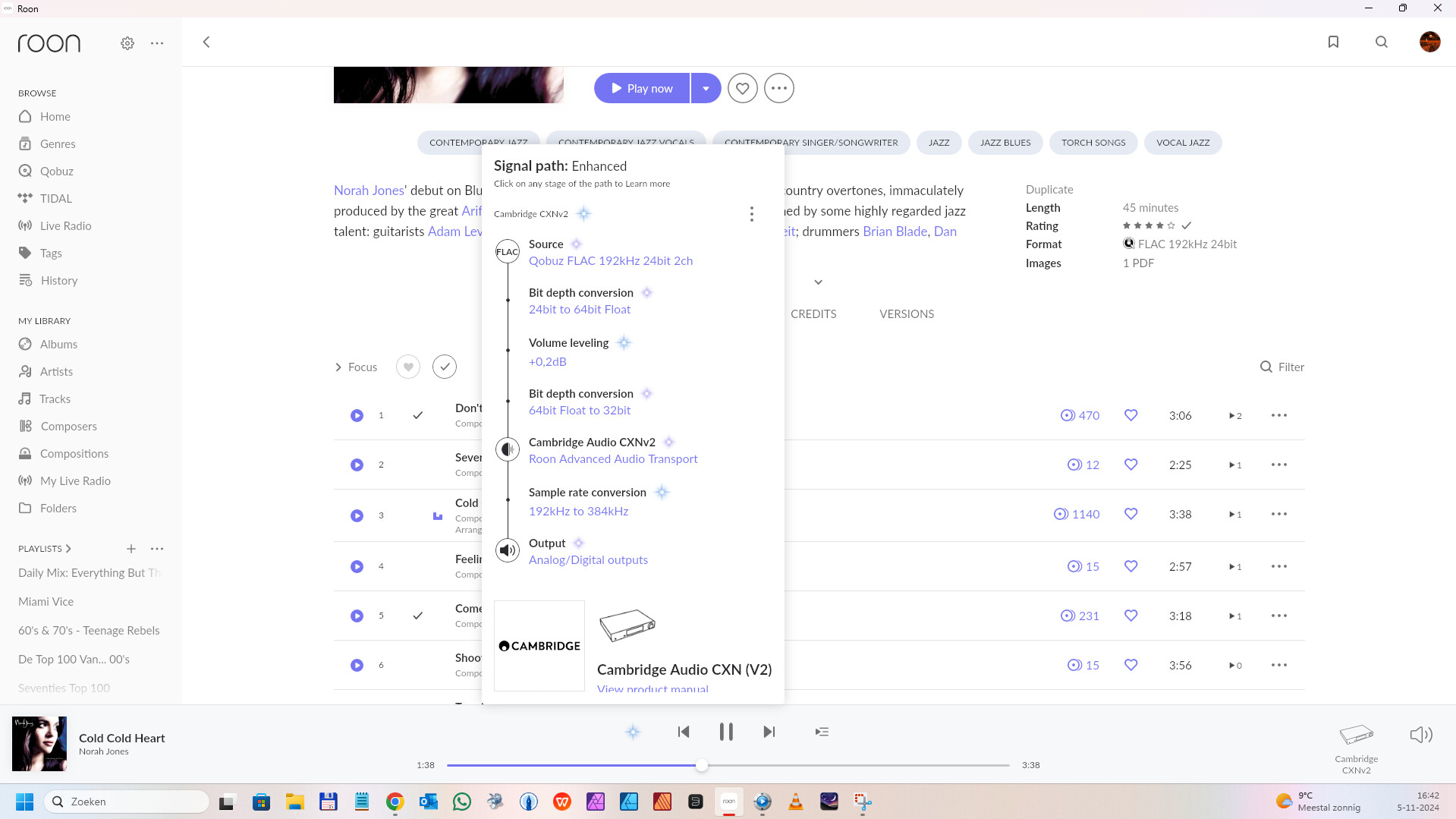

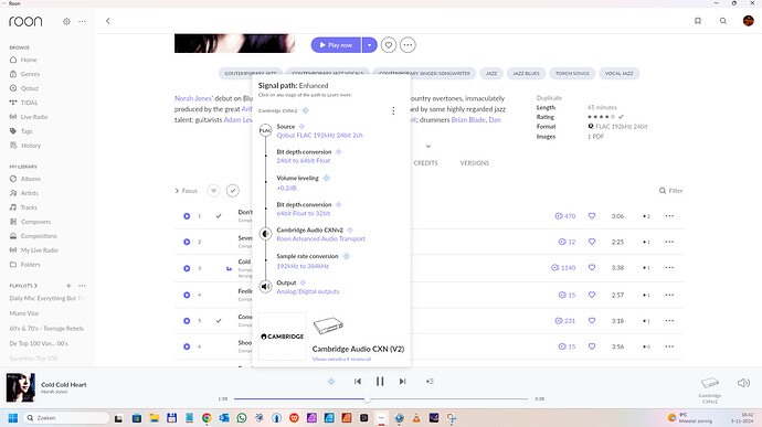

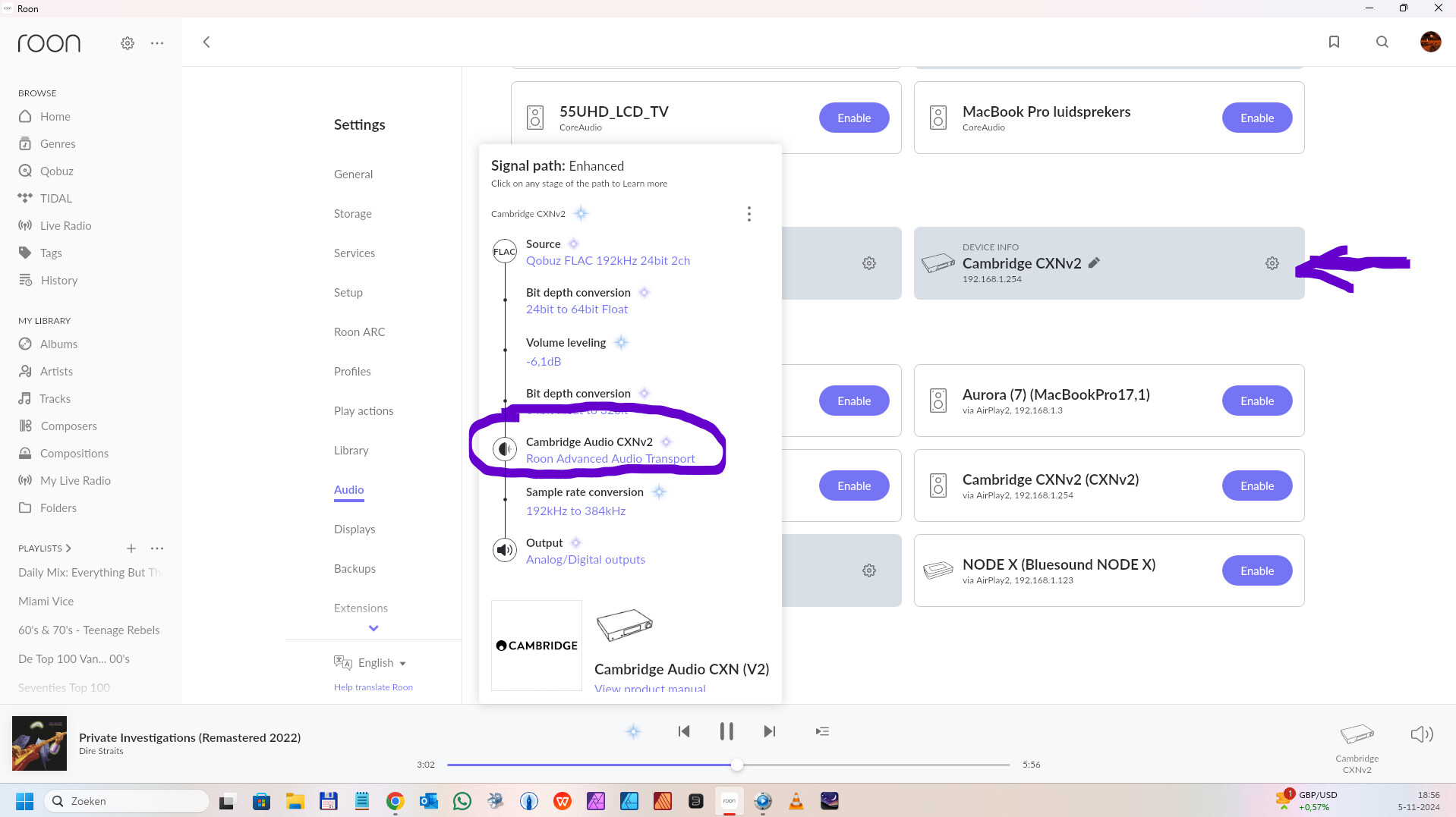

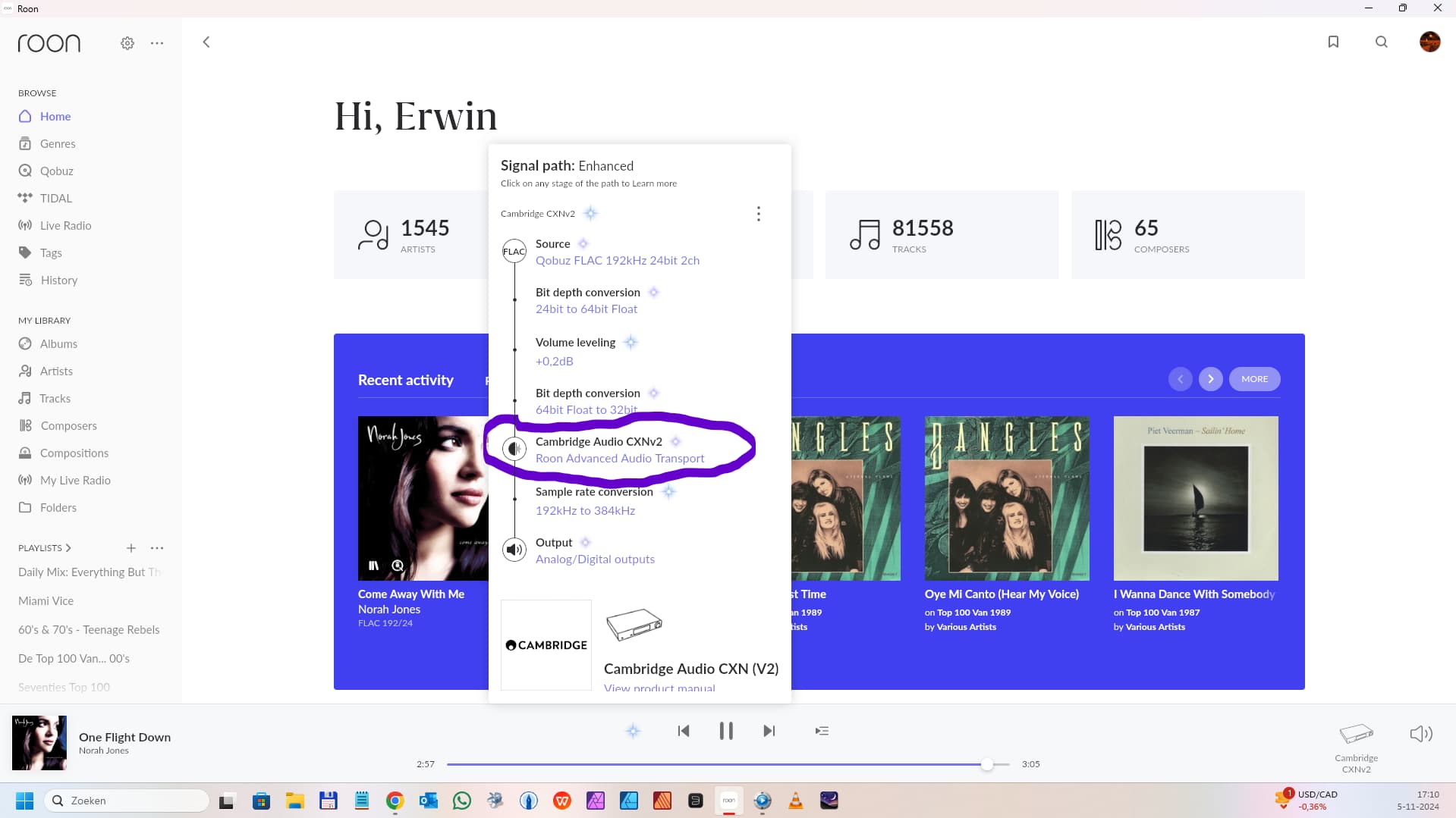

You will know when RAAT is working if you see this appearing in your signal path.
I have my Roon Ready CXN100 set for the max sampling frequency and rate (32 bit/768kHZ) in the Roon Audio settings. Roon setup these settings as “Default” as it recognized the CXN100 as a Roon Ready device when I enabled it. Is there anything else I need to do to enable RAAT as my audio transport instead of Cast 2.0 or Airplay?
Yes. Set to Max.
Just select the CXN100 option that is listed under Roon Ready. And Roon will use RAAT. You don’t have to enable the Chromecast or AirPlay options for it to work. And with the Tidal settings set to max a 24 bit 192 kHz track will play as a 24 bit 192 kHz track.
