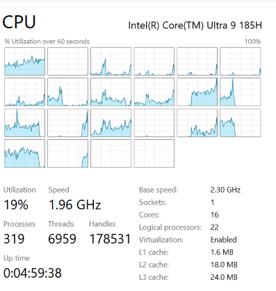

Here is a screenshot of each of the loading of each of the cores of my processor while running the Sample Rate Conversion in Roon and playing a track.
CPU Cores Performance
There are only about 3 cores actually running and the operating system has “parked” all of the other cores because they are not needed. Total CPU utilization is also low.

But it seems, that in your laptop the turbo modus is not enabled btw. blocked. My CPUs are running until 5GHz while upsampling multichannel to DSD256 (needs much more horse power than upsampling stereo to DSD512).
So check your laptop settings for power saving or silence working.

For Roon the single core speed is more important that the numbers of cores. Your are correct that the Processing Speed of 0.8 on a single core is too low for the other processing Roon needs to do. Dropouts and skipping occurs when my processing speed is dragged down to 1x.

You need to look at each core not overall utilization.There are some things, like sample rate conversion, which only run on a single core per channel so if you run out of horsepower on the core the others cannot help. As @Mike_LC noted, this is why single core speed is more important for Roon.
You may also look at the thermals and especially with trying to use a laptop. If one core is getting you > 1x speed but then is throttled because of thermals you’ll drop below 1x and get a drop out (not clipping, I’ll get to that). Sounds like you’re really close but 512 may be possible on that laptop without some tuning.
