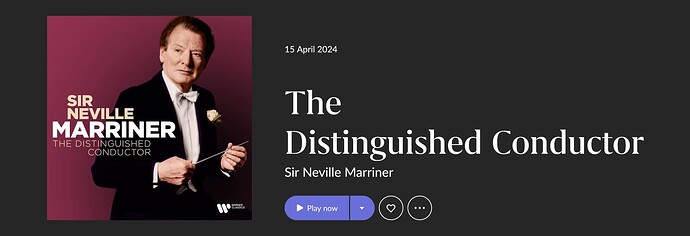

This is a new question to an old issue: how to force recognition of a composition? The subject album is 11 hours old, but 15-20 compositions are not identified.

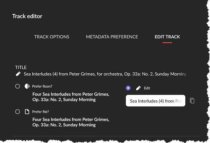

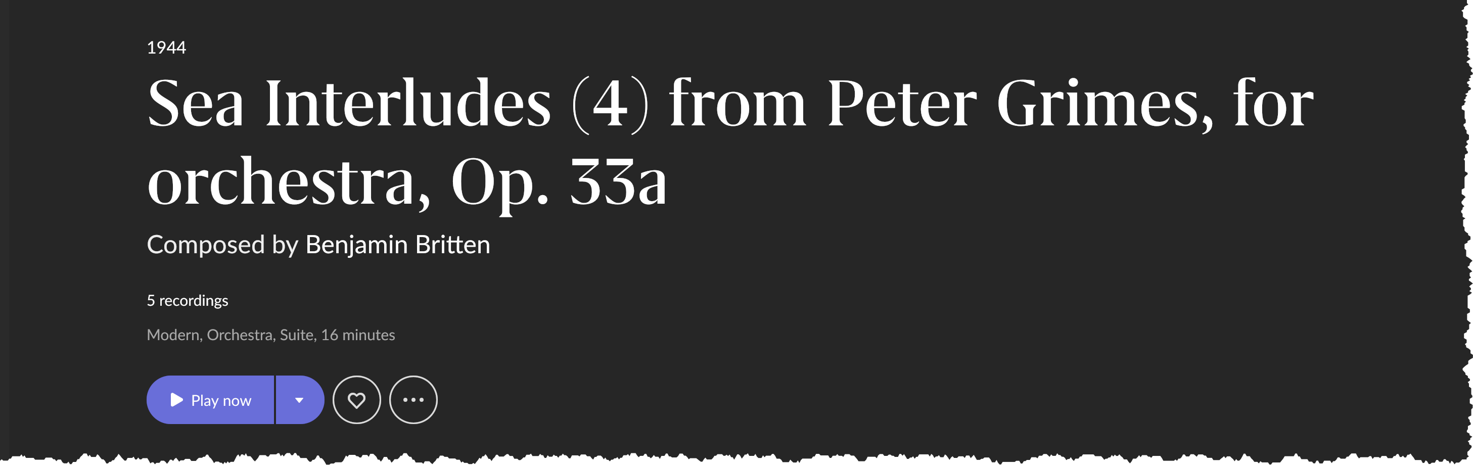

One example will explain. The Qobuz album has a piece entered as “Four Sea Interludes from Peter Grimes, Op. 33a: No. 2, Sunday Morning”. I first pulled up the composer’s compositions as follows:
I then copied the correct canonical title and edited the composition:
Finally, I ordered a Re-analysis of the track. But still it remains unrecognized
Yes, see above edit.

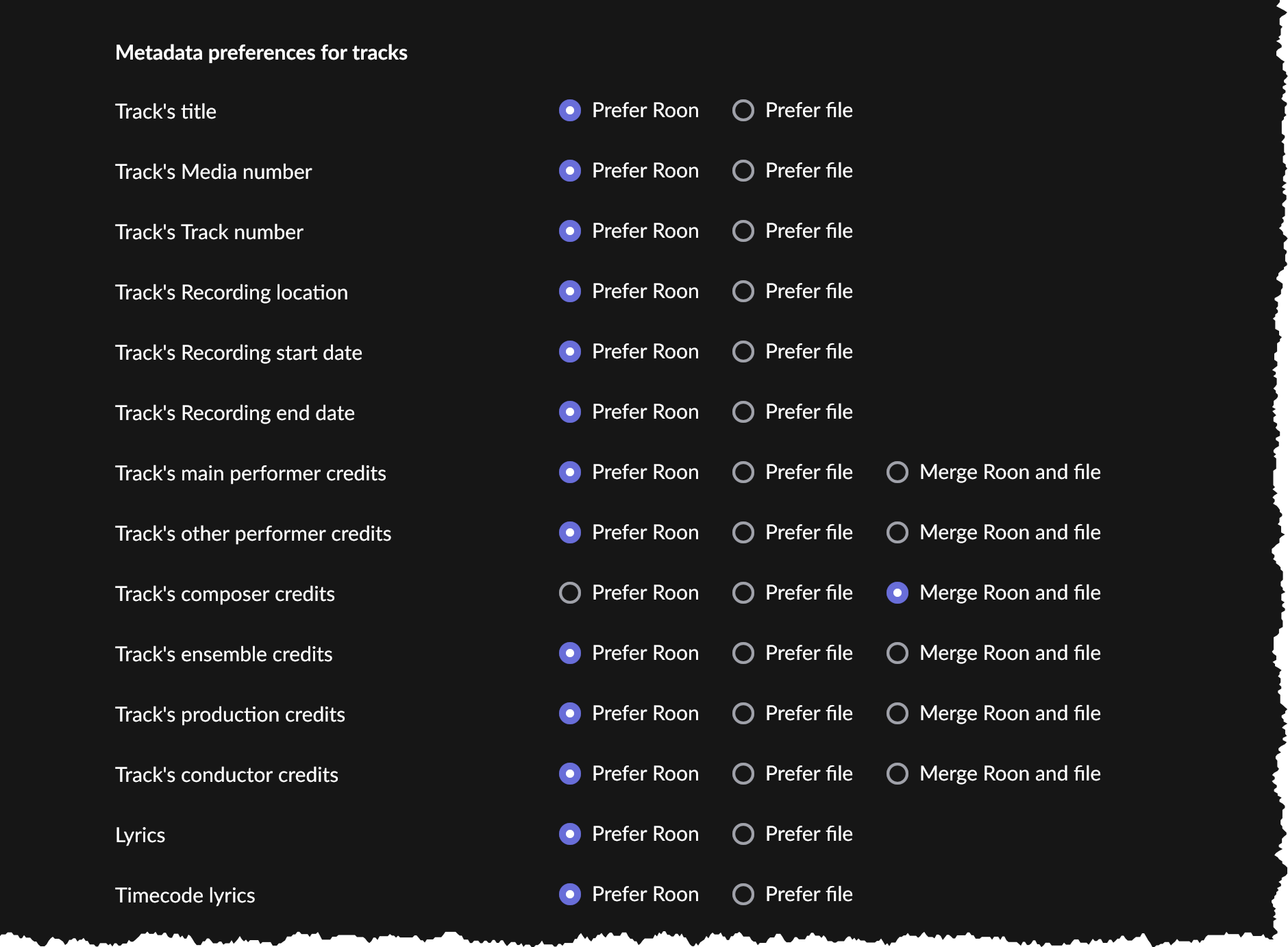

Screenshot of import settings
Track settings are below:
Description of the issue

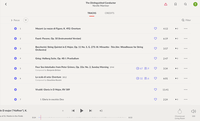

With Version 3 adding composer credits allows you to merge compositions. I hadn’t the patience to test them all but I added Britten to your example and Rossini to the track below which was also an unmatched composition:

One other note. My “version” of the album has many more recognized compositions than yours. My cuts 1 through 4 are all recognized (see original post), but they all have composer entries.
