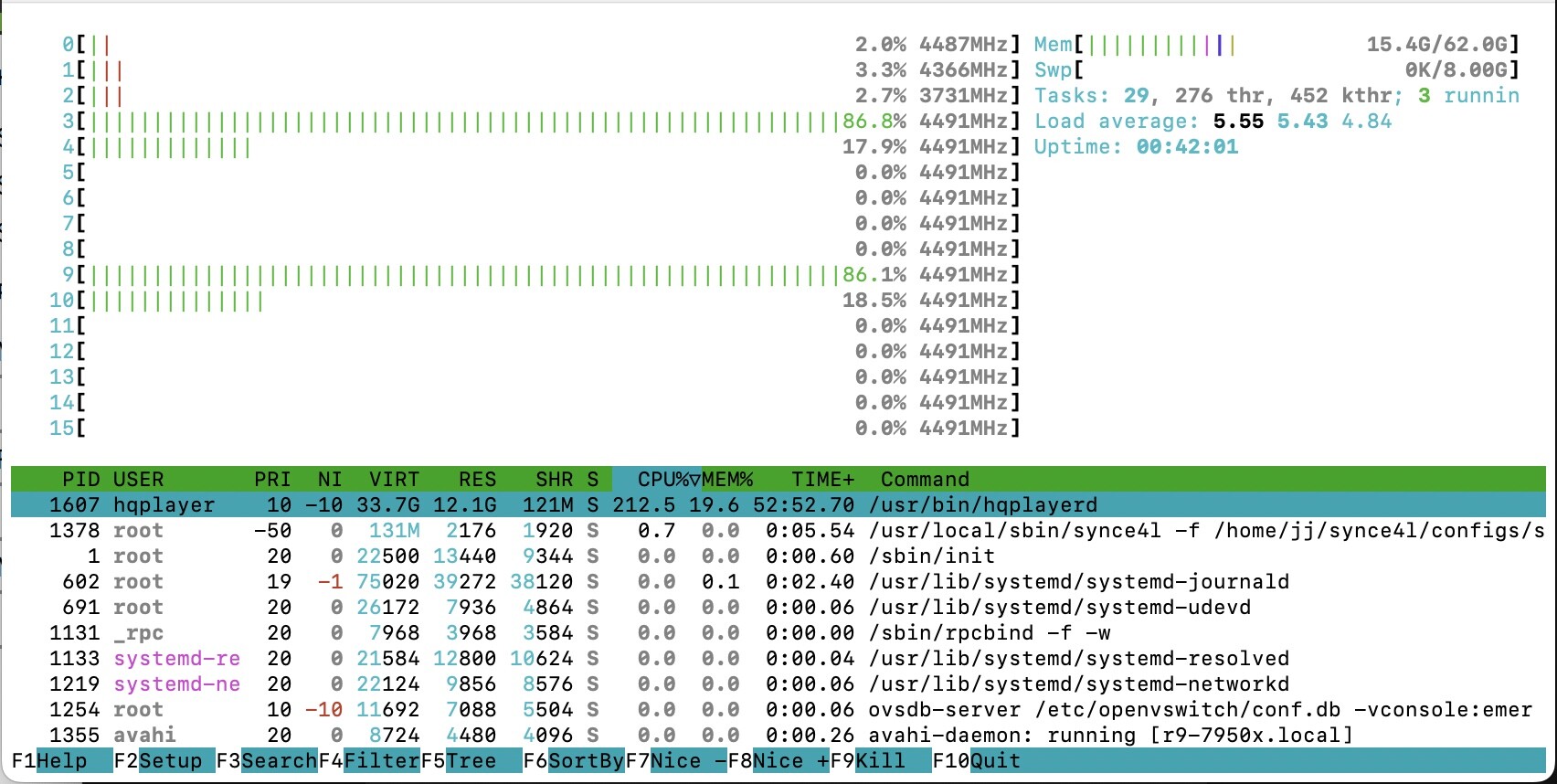

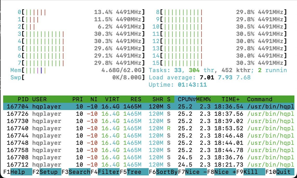

Before the parameters, here’s the some screenshot when running:
192KHz source / sinc-MGa / ASDM7EC-super 512+fs → DSD512x48
With PEQ text and DAC corrections. Here’s the AMD 7950x CPU loading:
sinc-MGa took some space of my 4090:

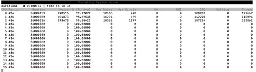

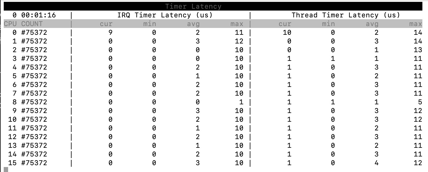

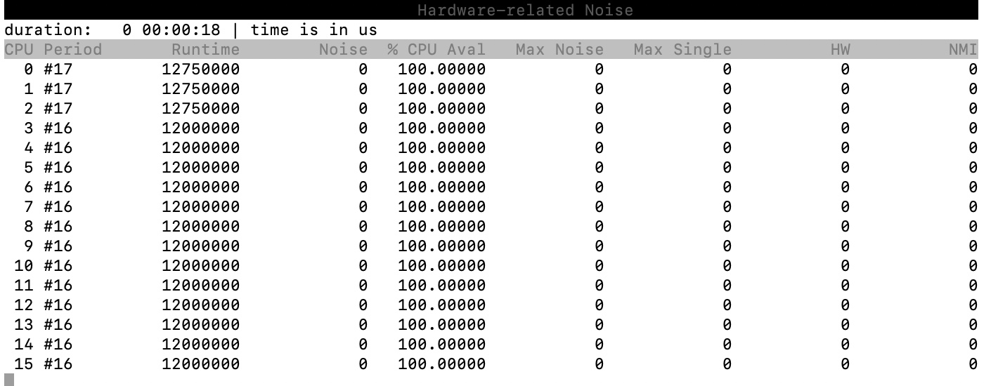

Here’s some OS jitter / latency info from RTLA tool:
Average timer latency looks ok to me (<5us).
CPU 3~15 are completely isolated from OS noise for hqplayerd.
Also free from HW noise.
