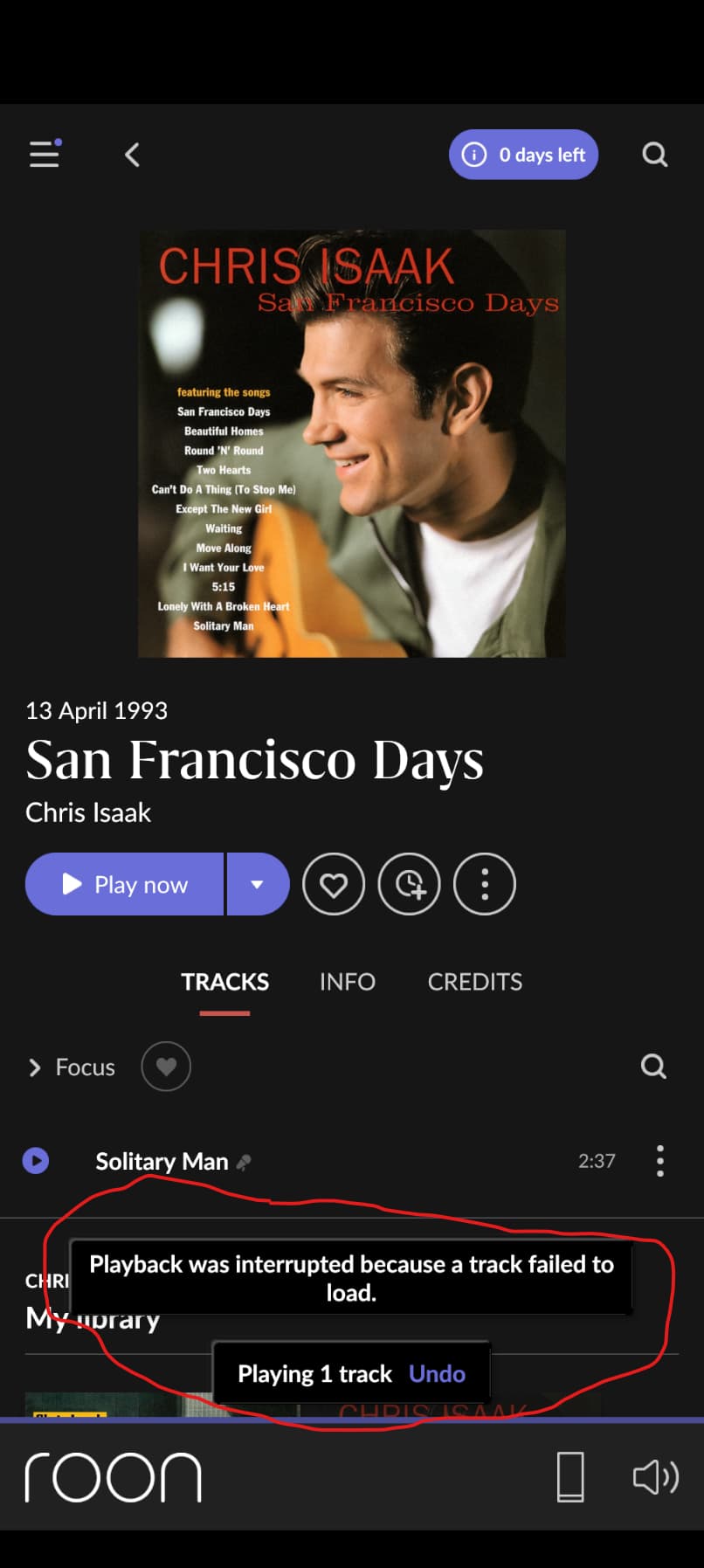

OK here’s something interesting. The tracks in /music2, while they are listed in the Folders view and under Artists, Albums, etc will not play. For instance:

What’s interesting is that Roon can’t actually play any of the files it sees in /music2. So Roon knows about them but cannot play them.

When I try and play one of the tracks in /music2, the log shows:
02/07 14:04:22 Error: [Worker (2)] [zoneplayer] Unexpected Failure While Opening Sound: /Chris Isaak/San Francisco Days/12 Solitary Man.m4a: System.Exception: failed to open location '/Chris Isaak/San Francisco Days/12 Solitary Man.m4a': IoFailure
   at Sooloos.Audio.MediaDecoderAudioSignal..ctor(String location, CacheHints cachehints)
   at Sooloos.Broker.Transport.AudioSignalFactory.<>c__DisplayClass0_0.<Create>b__0(CallingThread cx)
02/07 14:04:22 Info: [Worker (2)] [Pixel 9 Pro XL] [zoneplayer]     Open Result (Playing):Result[Status=UnexpectedError]
02/07 14:04:22 Warn: [Worker (2)] [zoneplayer] couldn't play URL /Chris Isaak/San Francisco Days/12 Solitary Man.m4a: other error
02/07 14:04:22 Warn: [Broker:Transport] [zone Pixel 9 Pro XL] Track Stopped Due to Error
02/07 14:04:22 Info: [Broker:Transport] [zone Pixel 9 Pro XL] OnPlayFeedback StoppedEndOfMediaUnnatural
02/07 14:04:22 Debug: [Broker:Transport] [zone Pixel 9 Pro XL] _Advance (Track)
02/07 14:04:22 Trace: [Broker:Transport] [Pixel 9 Pro XL] [LowQuality, 24/44 MP3 => 24/48] [100% buf] [STOPPED @ 0:00]
The files were never moved from /music to /music2.

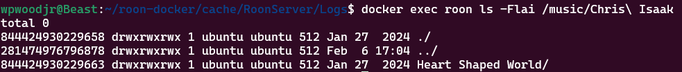

Try stepping back from the position that Roon is the cause, and execute docker exec roon ls -Flai /music/Chris\ Isaak. What do you see?
