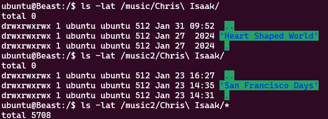

Also, here are the two “Chris Isaac” folders:

Both Chis Isaak albums show in the Roon Android app as being under All folders > music > Chris Isaak.
However, one is actually under /music (“Heart Shaped World”) and the other is under /music2 (“San Francisco Days”), as shown by this listing inside the docker container:
Somehow Roon is merging /music2 with /music.
No, Roon isn’t merging them since you have only setup one watched folder in Roon. The issue is with your container.
What issue are you talking about? The container is set up with two separate music folders. You can see by the file system listings above. Yet Roon is showing music from both folders as if they were merged.
