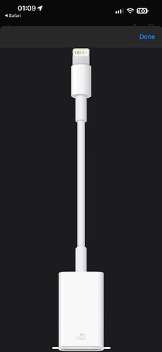

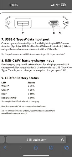

I’ve been using my iPhone 12 Pro Max and 14 Pro Max with the Hip DAC2. All you need is the lightning to USB Camera cable NOT the USB3. The user manual also has this info. The standard USB Camera fits the hip DAC port and that’s the only cable you need between your iPhone and hip.
Does look confusing on the manual where it says USB3, but it’s just the USB camera cable. The USB3 is the one which is wider.
https://www.apple.com/shop/product/MD821AM/A/lightning-to-usb-camera-adapter?fnode=0c4e82e633b4a618b11307f20b2a42632b9e8928536050d33b1f8f0cdcc3a6f7b73a9e8ff63183294f7be9da0e058059ab28b92db281fee699f302d84d99be5214fbff15fa0b1b4e2e0a8e93caa5a2e80807879dcd65fc0ed78cf85ab3687e9aa1a081f5581c7634b62c3eb5db037cbc
Thank you I just ordered this and it gets here Saturday and I will test it out! The original one worked but was an off brand one on Amazon and it did not fit directly into the Hip DAC 2.
