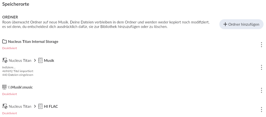

Hello, thanks for the hint. Then it is certainly helpful that my collection is distributed to different hard drives that I can disable the sources as needed.

I have around 70K on my USB drive , I let Roon index it before Disabling it . If I re-enable it it comes live almost immediately . it takes maybe 2 mins to read in , certainly a lot less than a “from cold” index. This suggests that Roon already has the appropriate info in the database, but excluded as “disabled”
The home page only shows the files on my active internal SSD in the NUC
