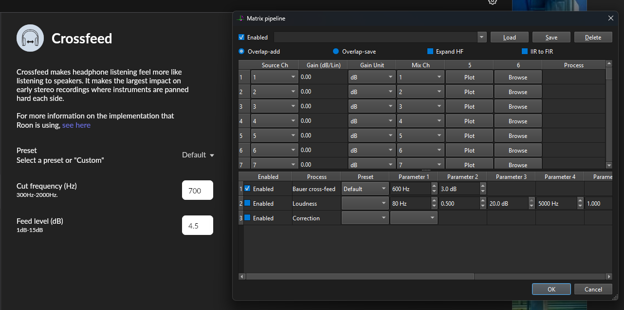

In the attached image i have Roon crossfeed settings, on the right is hqplayer 5s pipeline settings.
If i wanted the same crossfeed settings from Roon to be added to hqplayer, would i do the following in hqplayer?
  1. Click ‘enabled’ in top left of matrix pipeline
  2. Click ‘enabled’ next to the ‘bauer cross-feed’
  3. In Paramater 1 i would put the cut frequency (Hz) from roon & Paramter 2 would be the Feed Level from Roon?
So in this example, my “bauer cross-feed” settings in hqplayer would be preset: default, parameter 1: 700, parameter 2: 4.5dB?
Thanks in advance!
Yes, exactly. But if you like to use those parameters, set Preset to Custom.
