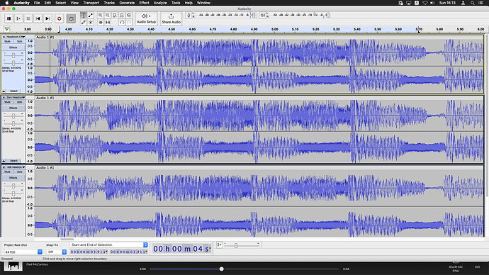

I do not know how to overlay them. (and they are aligned by eye)
But: first one headroom disabled
Second: Zero Headroom
Third: -3 headroom
The first two look the same to me
Just found the zoon tool (those app all with different shortcuts… who uses cmd + 1 and cmd + 3 for zoom in/zoom out)

I did aligned them a little better and still see no difference
Let me help you out…
Firstly, you can zoom in on a sample by sample level to align perfectly.
To show the difference between both trials for one channel, you need to first invert one trial’s track, then mix it with the other non-inverted trial’s track into a new track.
So “Select” a track (button in bottom left of track window).
Click “Effect” “Special” “Invert”.
Track phase should now be inverted.
Select inverted track and non-inverted track of same channel.
Click “Tracks” “Mix” “Mix and Render to New Track”.
Voilà, you should see the difference between both tracks…

The aligning was the hard part… But I suspect that this is the result you were expecting
If you play them back if there is no difference it should be completely mute as one cancels out the other. This is how I have tested stuff in the past. I don’t suspect there will be any difference as it’s likely just the act of switching causing our brains to think there is one. As it’s not a switch that happens instantly audible memory isn’t very reliable. I also tend to have the two recordings I am comparing on separate tracks and toggle between them as it’s instant with Audacity.
Yep. nothing there.
Playing and nothing comes on the speaker graph.
