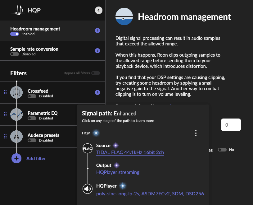

It is true that I have no headphones so I’m just using this with my speakers. Also I stream from roon to HQP (I do not know if matters as the settings changes are only in roon)
I did try with 0 headroom but still do not notice SQ change.
I did test with this (as I’m listening to it now)
Screenshot 2023-04-16 at 13.11.56
Have you got a better track?
As I’m alone I do not think that I can do a blind test
Not very safe to go without headroom I think, but if you edit your filters and none is adding (none on +) I would try and leave the headroom untouched (not because I notice any SQ difference but because less might be better)
There were some old threads, were someone from Roon explained about the headroom but I do not find them. And on 0 the signal path does not show any headroom (as in your screen)

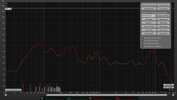

Having some time to play… I’m not sure that I did this correctly (for sure I did not align the two) I know I’ll get corrected.But it is fun. I was so annoyed that I do not hear it. Maybe I need to buy headphones :slight_smile:
So I hit play for 82 seconds with headroom at 0 (zero) and with headroom disabled. To me does not look any different (maybe just some noise coming from the window) mic is at ± 1m from the tweeter
My golden ears tell me that can not be true :wink:
Definitely less detailed highs going on :slight_smile:

Anyone convinced in that happening could easily setup a loopback of Roon’s stream to verify with appropriate free measurement software… or just use their USB mic to measure acoustically…
That was my second idea. To use Blackhole as output in roon (I think is a loopback) and record with quick time. Ended up with two m4a files, one with 0 headroom one with headroom disabled. But I do not know in what app can I open the two tracks and overlay them (rew wants aiff) if you have any idea pls tell me.
I’m not that skilful with REW and mic so I do not fully trust what I"m doing. I would be more confident in the loopback option since there is no outside sound recorded.
