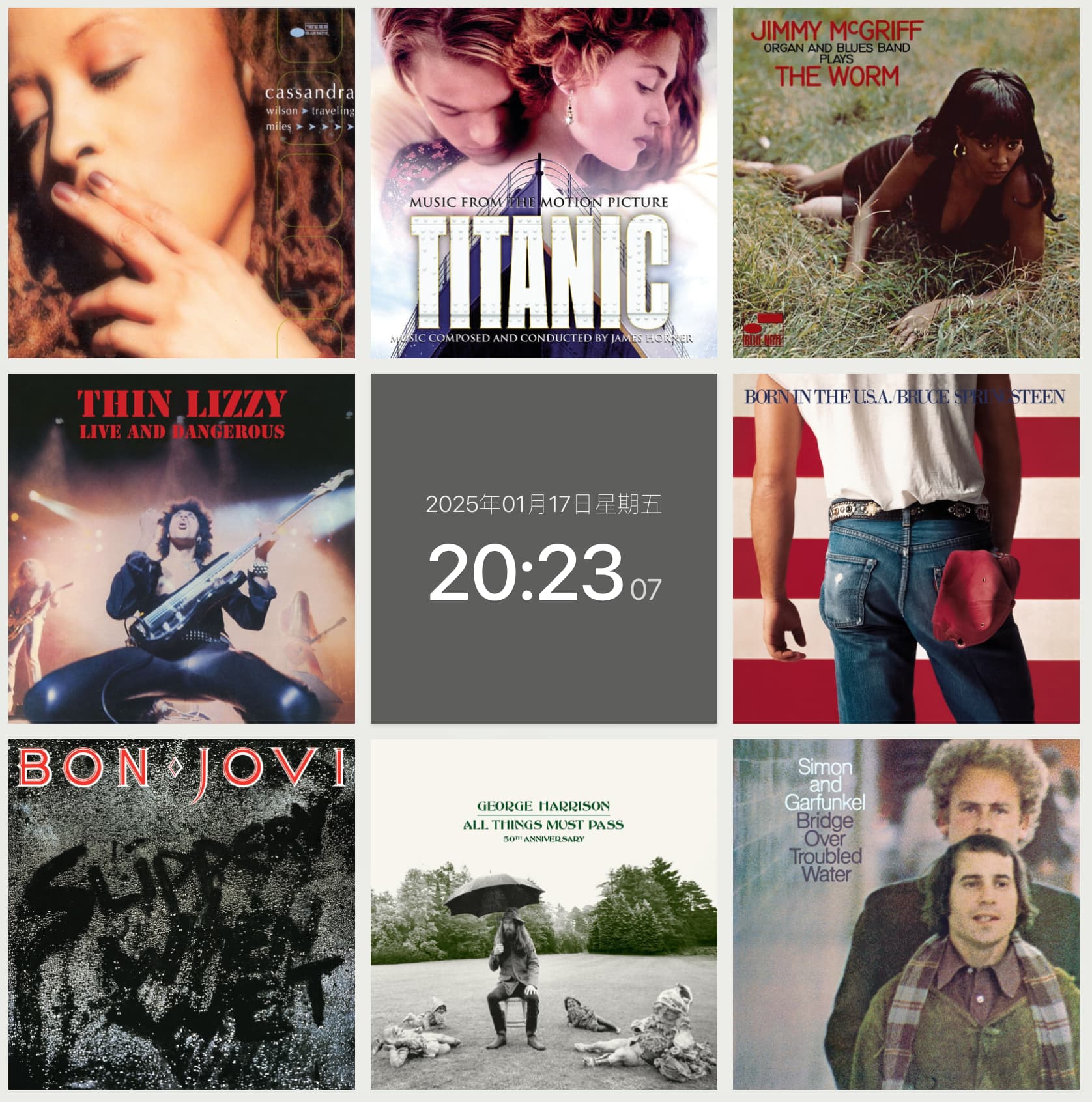

This extension displays album art from your Roon music library, offering both real-time playback visualization and a dynamic art wall mode.
Key Features:
  • Real-time Playback Display:
    • Shows the album art of the currently playing track.
    • Dynamically extracts the dominant color from the artwork to set the background.
    • Supports full-screen display for immersive viewing.
  • Art Wall Mode:
    • Automatically activates 15 seconds after playback stops.
    • Presents a grid layout of album art.
    • Includes a central clock display (except for 16.9 and small_frame options).
    • Randomly displays album art in the remaining grid positions.
    • Refreshes three images every 60 seconds with a smooth 3D flip animation.
  • Automatic Image Saving:
    • Automatically saves played album art to a designated directory.
    • Supports a custom save directory for organized storage.
    • Uses intelligent file naming conventions (e.g., Artist_Album Name).
Display Options:
  • 16.9: Optimized for 16:9 aspect ratio displays (widescreen monitors and TVs). Suitable for both landscape and portrait orientations. Does not include a clock. Recommended for 16:9 screens.
  • small_frame: Optimized for displays with a very tall, narrow aspect ratio, such as 1280x8000. Supports both portrait and landscape orientations. Does not include a clock. Ideal for specific, non-standard display types.
  • latest: Designed for square (1:1) aspect ratio displays. Includes a central clock display. Best for square screens.

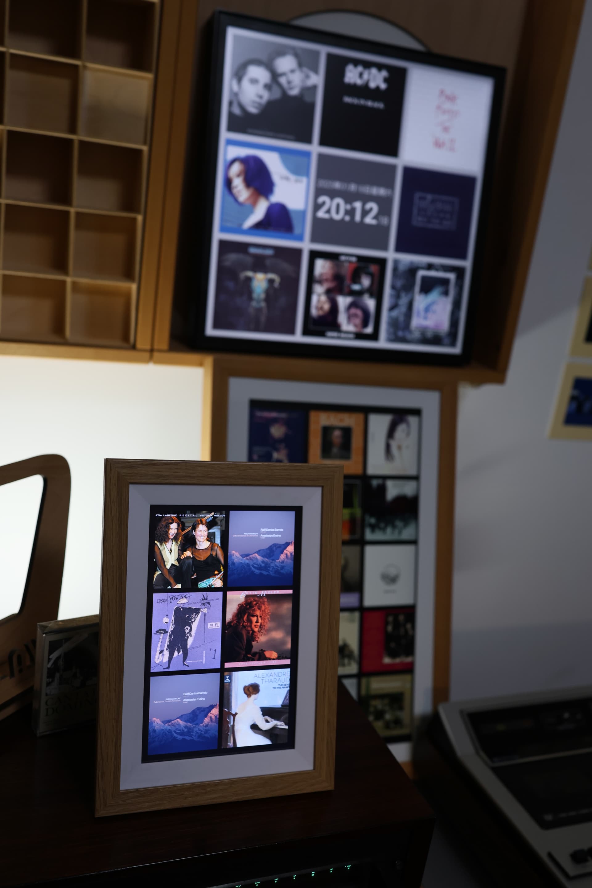

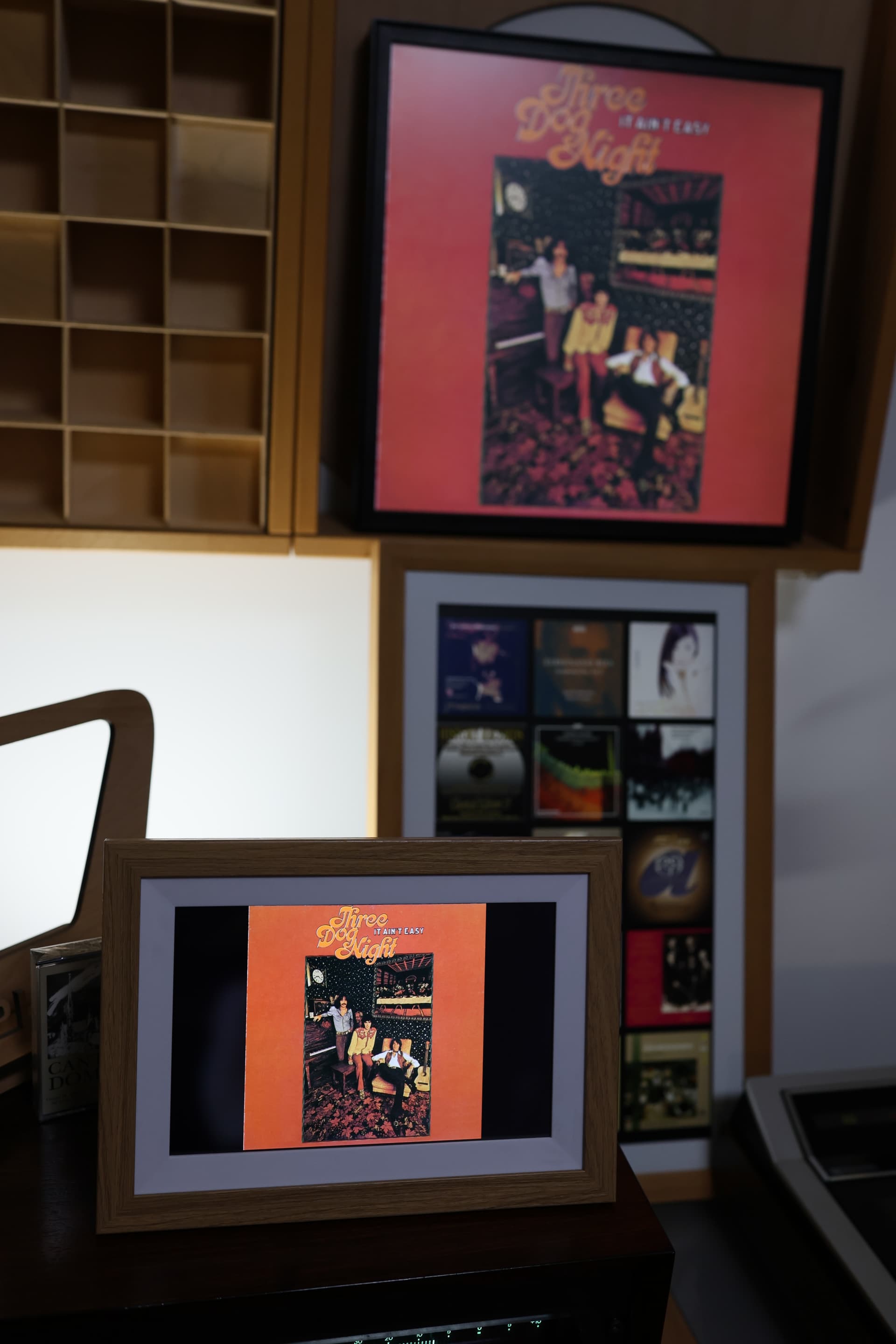

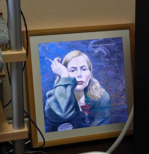

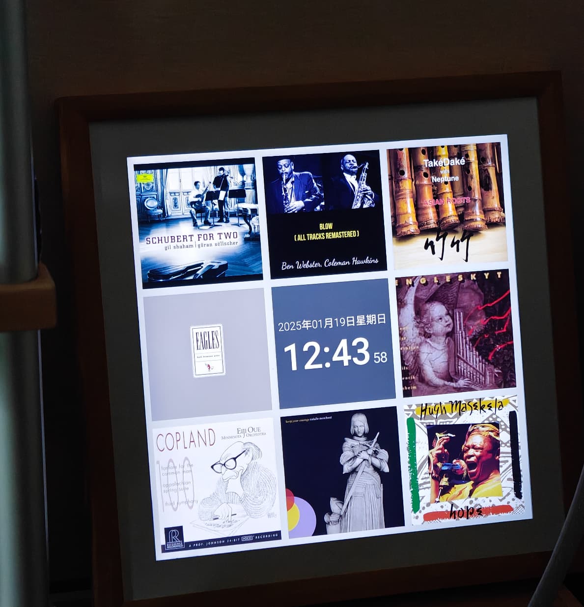

Really nice! What kind of displays are you using in the photo’s?
Wow, @Wen this is incredible. But I need a bit more explanation… I’m running this in a docker container on (my NAS? An RPi? What?). What browser am I using? On a dedicated RPi in kiosk mode? And where am I navigating to? I need a bit more step by step before. Because this is such a cool project.
I don’t understand code, and this project was completed with the help of Cursor. This image is suitable for X86 devices.
A digital photo frame that can install third-party software. I customized a webview that can start on boot and display in full screen, so…
Couldn’t find any square ones… that’s why i asked.
Really awesome project!
@Wen Thanks for this - I have configured the Docker based service, but am looking for good options for the client/display hardware.
If possible, could you please point to any details about the square digital photo frame that has a 1:1 aspect ratio? (Brand name or anything else? I would really like a square display for album art.
it was custom-made in China. I am not sure if it can be sold in your country, the frame is very fragile and the shipping costs might be very high.
