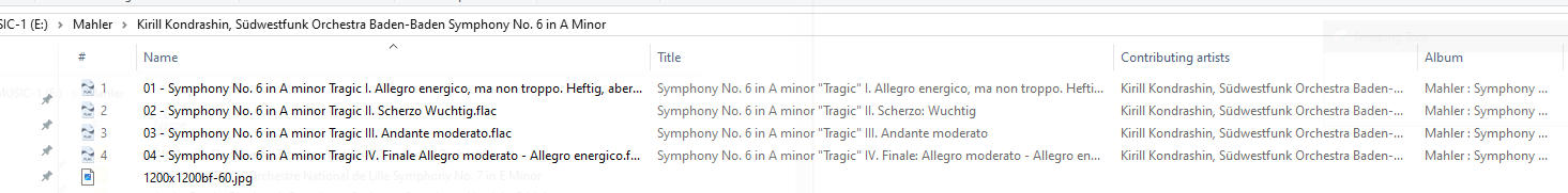

Can you show a screenshot of your file metadata in a metadata editor like Mp3tag?
This is for tehfiles in teh post. It seems like after a bit the connection between the files and teh database get lost.
Where is Symphony No.1 ? the match screen you show is only No.2 are you splitting the Symphonies into separate folders
The convention is that all the files off one CD should lie in one folder , Roon will see that as an album

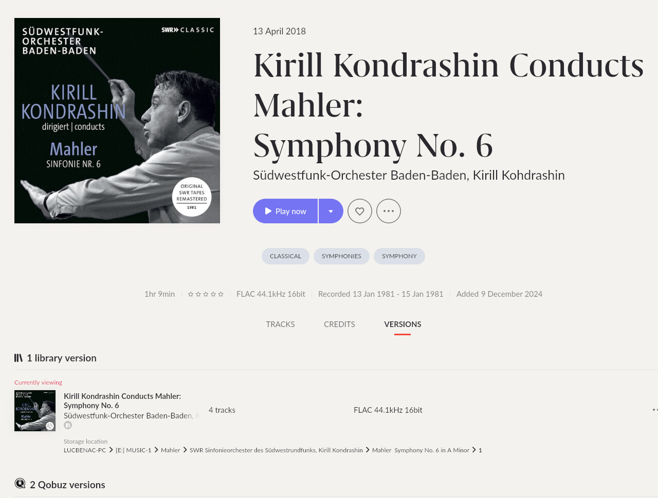

Well it actually also loose identification on albums that have all the tracks in teh same folder. This info was lost after a couple of days:
And it is available in the list so I have to put it back manually yet again. This feature seems to be a bit useless if not reliable

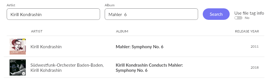

We need to see the next screen to comment, it’s likely a mismatch of track timings
Yes you will need to manually accept these track timings , it i quite common for the embedded timings not to agree with the Roon Sources, if its not a +/- 3 sec it will fail.

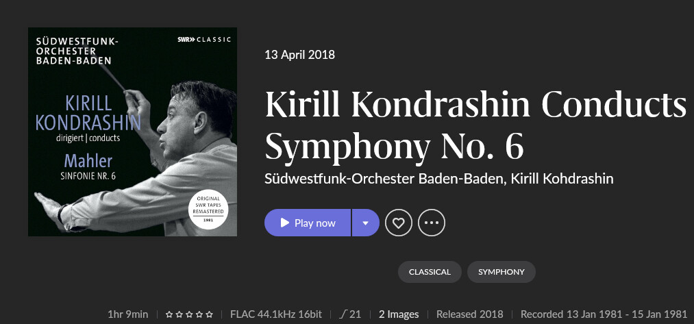

Yes I go through the same process. Linking the album manually overiding the 4/5 sec. timing difference. The issue is once I have done that, everything is good but a few days later that link is lost and the very same album shows as Unidentifed again. Thank you
Find the album. Overide timing:
Identified in the library.
But then thi smight become Unidentified again without any change after a few days.
Is it because the timing are not recorded as equivalent?

As far as I know the only thing that could make this happen is if the Roon reimported the album and went through the ID process again and failed as before. The only thing that can cause that is if your track files(or tags) are altered in some way. Roon will detect a ‘file change’ and reimport
Is something else changing your tags that you are not aware of , eg are you using Audirvana and adjusting stuff there , that will cause it
