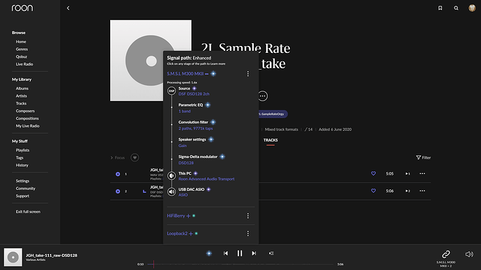

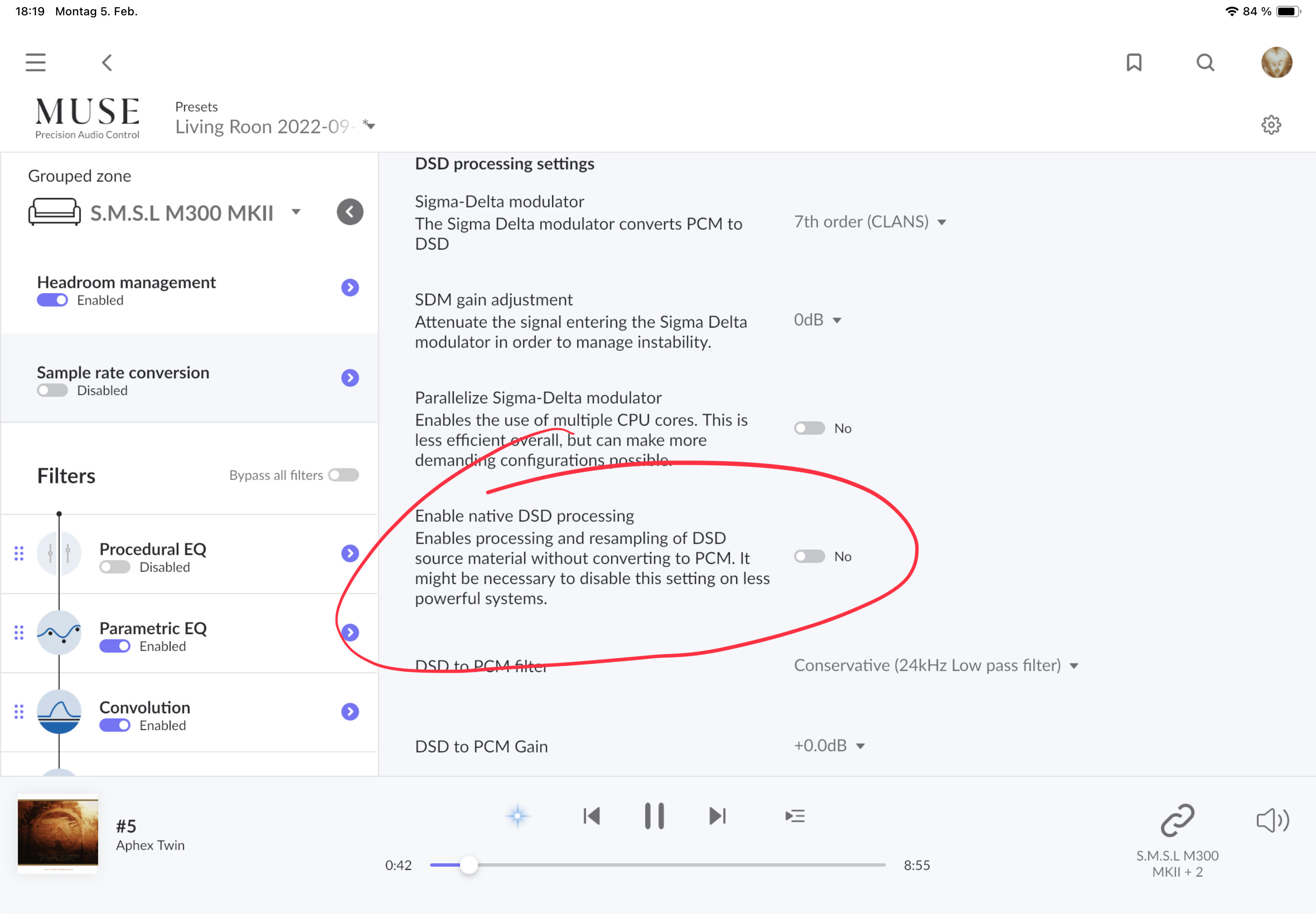

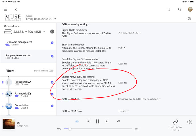

You could also use this setting set to yes … but no matter what you decide on, no variety of digital volume implementation can ever be bit perfect …
Sorry but this screenshot in no way answers my question and BTW this setting is for upsampling dsd directly to a higher sampler rate of dsd without going to pcm.
This has nothing to do with volume control or the Ares2 and its usb volume driver, but I get your point about no variety of volume control on the sw side keeping it bit perfect.
EDITed out my emotional digression :wink:
You got me wrong here, since there’s no need to use upsampling options, but only use DSD native processing to use Roon’s DSP volume control without PCM conversion, just set upsampling to “for compatibility”.

Okay, just checked it out with DSP volume in device setup, and what can I say other than apologizing for having been wrong all along … sorry for drastically raising the signal to noise ratio in your thread!

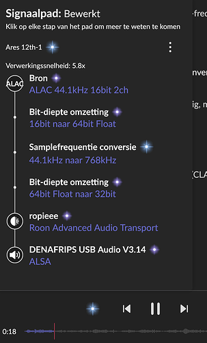

I just did the firmware update. And now I am able to control volume on the DAC. So not using DSP volume.
Can you please try playing dsd files. According to vinshine it will not work.
DSD files do play. Only problem : volume is maxed out with DSD. So I have roon set to convert those to PCM.
Yes, that is the issue, this is why when you use Dsp volume dsd files are also converted to pcm, but with the driver at least you can convert to 768khz, whereas dsp volume auto-converts to 352.
