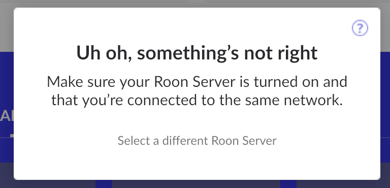

Setup: Roon server running on a MacMini.
Endpoints: Various, but the one in question is my MacBook Pro.
I’ve been happy enough with my MacBook Pro + Grado SR325, however my work’s VPN (which I connect to off/on throughout the work day) routes all network and when I use it, I cannot listen to my Roon.
I am contemplating setting up something else in my office for this. RaspberryPI setup with a DAC/amp? I can use Roon remote on my Android tablet or an iPhone…
Sounds like your work VPN is blocking external stuff , I doubt any hardware streamer will be any different .
When I was working out IT guys blocked all sorts of sites notably Facebook and Twitter. The claim was a productivity improvement which I could believe if everybody didn’t use their cell phones instead !!
@Mike_O_Neill I have a VPN on my MacBook Pro. When I use it, I cannot connect to my Roon server.
I am looking for a standalone endpoint that is not my MacBook Pro. I do not need it to be portable, it will be on my desk.
Mojo (amp) +Poly (streamer) ?

Actually, what’s happening is that Roon server cannot discover Roon running on your MacBook. However, if you turn off the VPN briefly when starting the Roon client, it will be found, and will continue to work when the VPN is re-enabled.
Another option. I just loaded RoonServer on my laptop and when at work use it locally with a USB attached DAC; then switch back to the home server when I’m home. At work I don’t bother with local files and just use Qobuz. Works like a champ and i don’t have to deal with messing with the company network.

I’m in a similar situation. I solved it by deploying a little Raspberry Pi 4 at my desk. For work Zoom calls, I switch my Topping E50 to the Optical input, to which I have my work laptop connected. For music, I switch the E50 to the USB input where my Rpi 4 Roon endpoint lives. Desktop “beeps and boops” I have routed to the speakers in my work MacBook Pro (via Rogue Amoeba SoundSource) so that I don’t miss important notifications.
