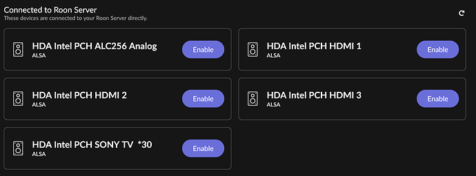

Did you enable the HD Audio driver in Dietpi Config?
As Simon mentioned you have to enable HD Audio in the dietpi-config app and I think reboot, it’s almost a year since I did it, but I vaguely remember having issues with this, and I did some googling to find that answer. You still end up with several devices
It was also important for me to limit my output to my Sonos ARC to get audio out as below, but this may not be required for you.
I think I have :slight_smile:
Torben
Just logged onto my machine and it is set to default, (which is the same as yours if I dig into it) (after ALSA is installed).
Can you check that in Software that ALSA [5] is installed? (which it should be or I would not expect to see these as I see you now posted a screen shot).
On mine only HDMI0 works, but I guess that could be different for each device. I also get no music if I leave it at 32 bits and 96 as per my screen shot above.
It is:

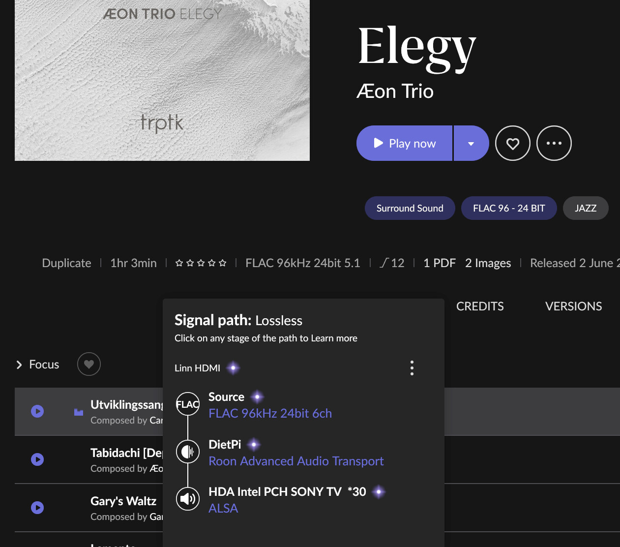

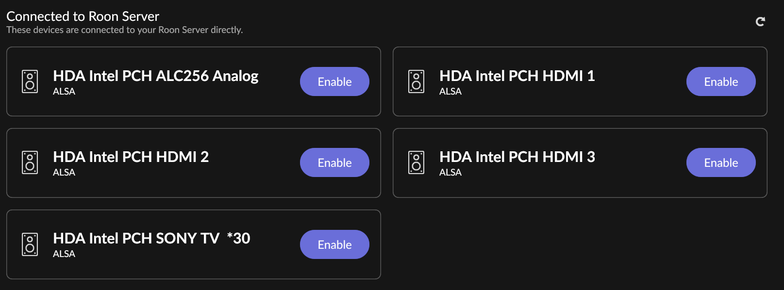

Your HDMi 0 appears to have Sony TV connected to it looking at your screen grab. Did you change that name?
No, did not change anything there. The Sony TV is just connected to my Linn (ARC)
Torben
Well that has changed so maybe try that one as it may have picked up something when it was connected. What are you connecting it to then?
Try reducing it as shown in my screen shots as HDMI sometimes has a limitation (like the Sonos) and does not work at any higher.
Just give that a try, reducing output down to 24/48

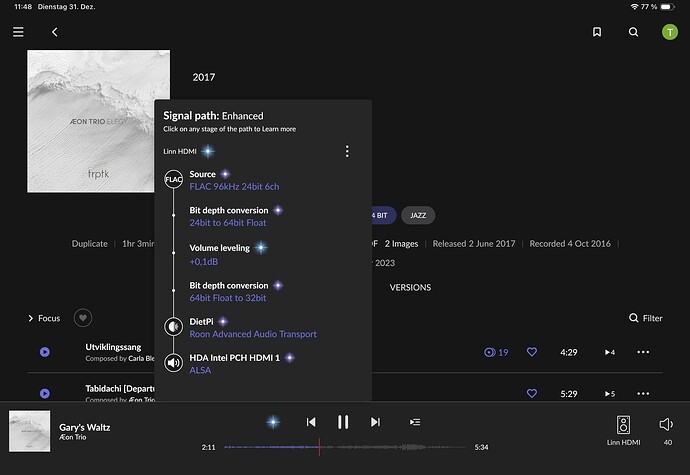

You are right :slight_smile: It don’t say HDMI0, but it seems to be HDMI0. Just did a test, and it works just fine
