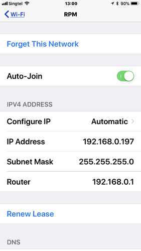

You can find the basic settings for your Wifi on your iPhone/iPad in info on the Wifi connection as seen below. DNS should be automatic…but you can plug in the Gateway address as this will work or if it doest just use 8.8.8.8
