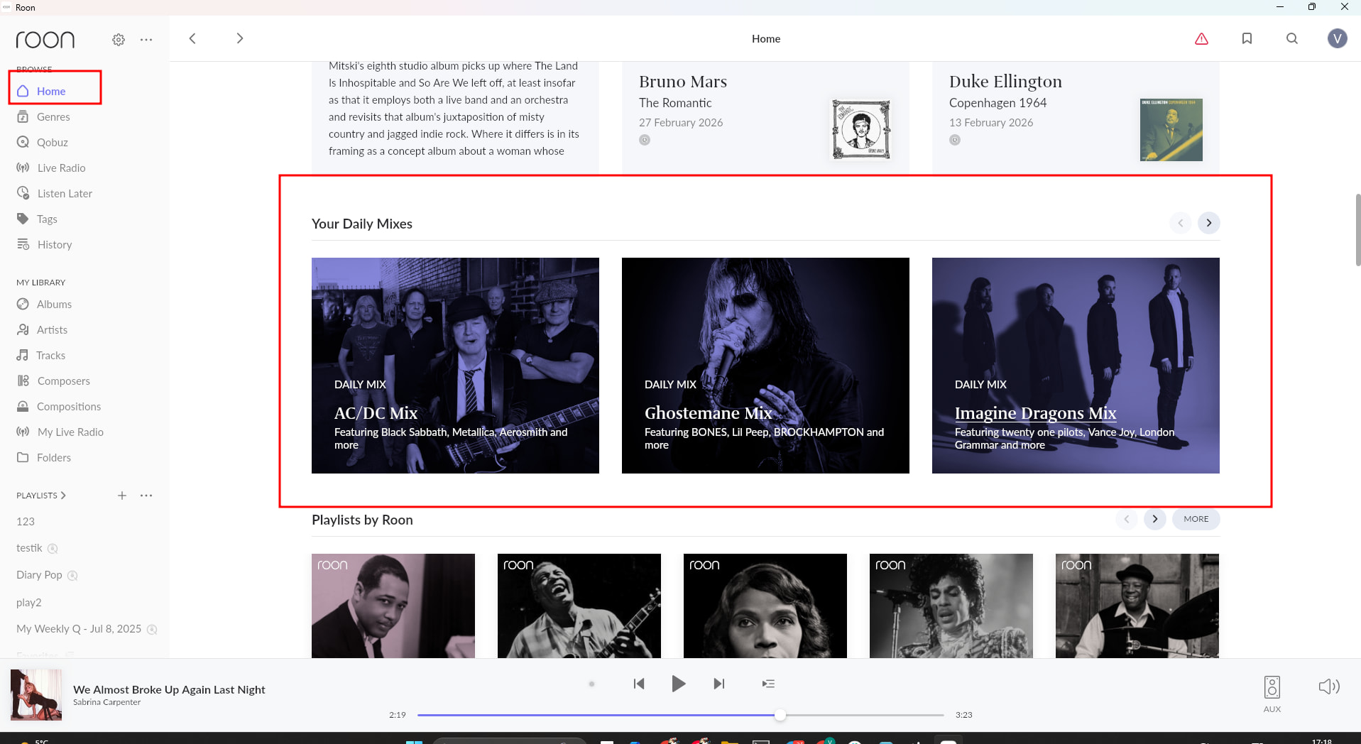

At this point, I’m curious to know what’s the expected result if this API doesn’t fail? I’m asking this because I think I’ve never seen it work so I’ve never seen the result on my front page.
Can you please share what information has been missing from my front page because of this? A sample screenshot?
Hi @vadim
Thank you for the screenshot.
That looks cool but I don’t think that’s a critical feature for me. But the current problem is it blocks loading my page for a long time. Every time I open the home tab. I have to wait a minute to see the rest of the page. It’s very frustrating.
If we can not fix this easily, how about adding a config option to turn off the tidal daily mix? Probably to this panel?
I want to turn that off until we can fix this issue.
