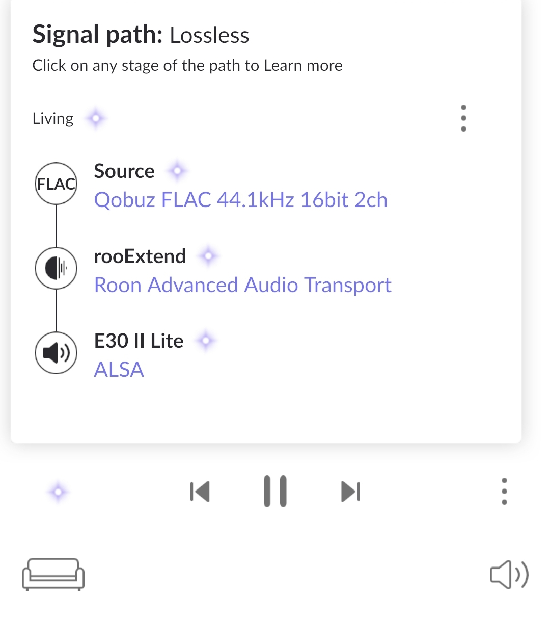

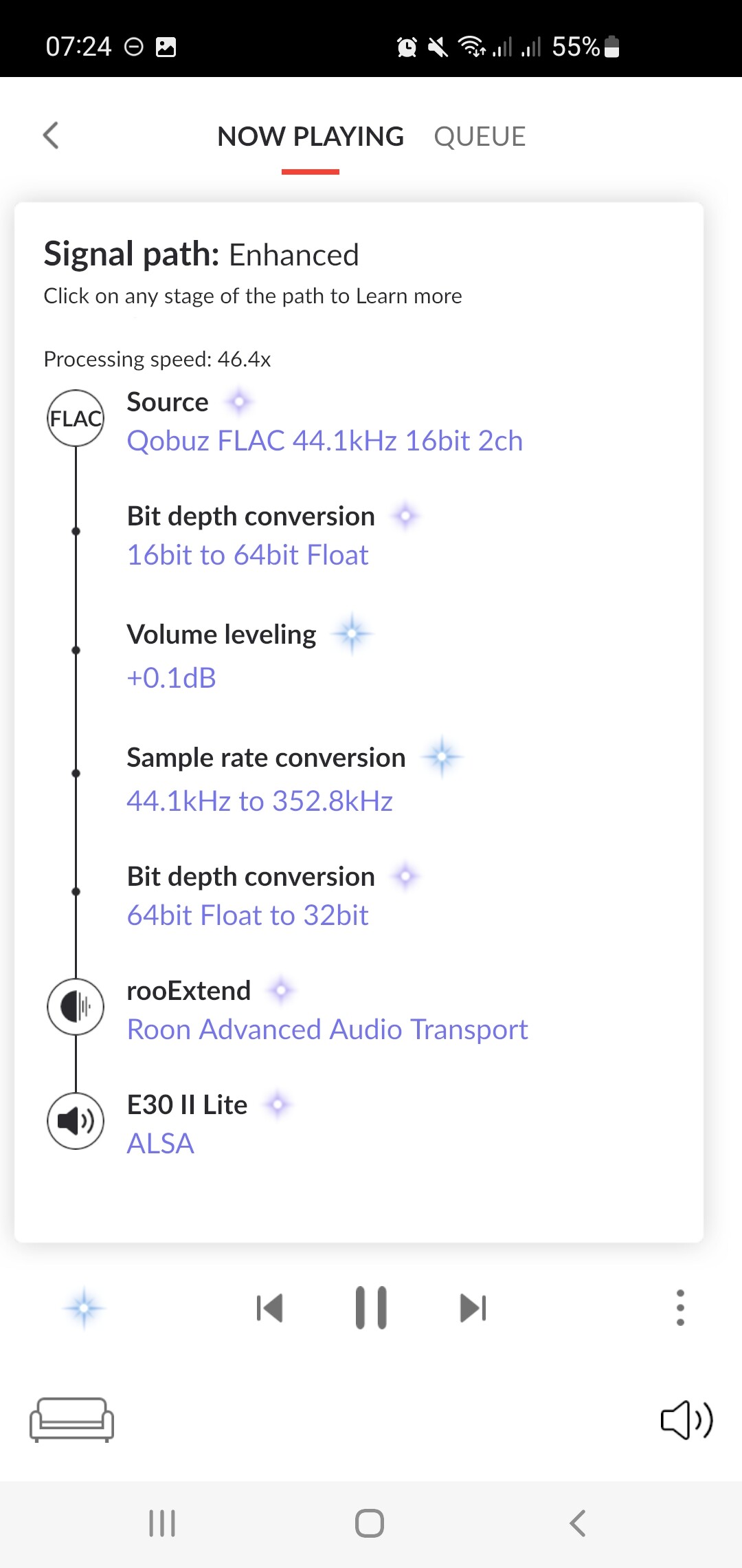

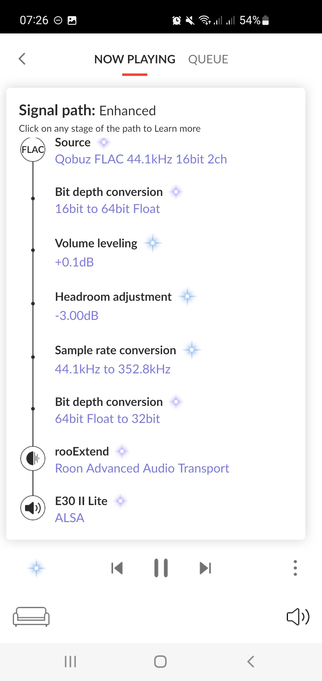

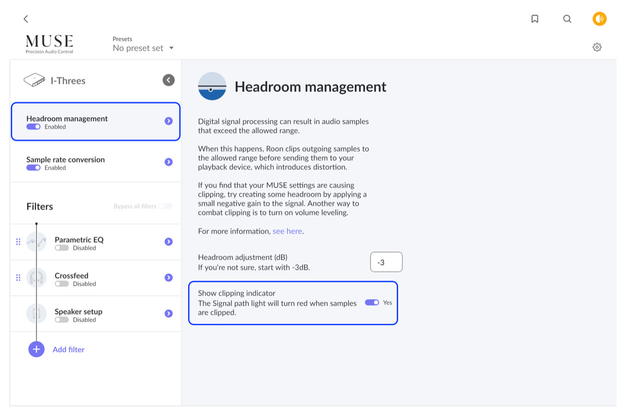

Give us a screenshot of your signal path and also set up the clipping indicator to indicate such instances, as in screenshot from the Roon help pages.
Thanks for helping me out! I’ve started digging a bit:
@Menzies : power supply is done through the stock AC/DC power supplies.
@SukieInTheGraveyard : amplification is done by a Yamaha RS700 stereo amp, had it over 10 years, never had any issues with it. They are powering a pare of B&W’s.
@Marin_Weigel : it doesn’t seem to help much; these are the different screenshot with all the smarts enabled and disabled. Still the same. :fearful:

I was aiming at detecting digital clipping, especially with upsampling, but bare bones should not digitally clip - oh well.
But your Topping has a pre amp mode, so try setting this up and lower the output level into your Yamaha, since its input might be overdriven into clipping in the analog domain - of course you could also set Roon’s headroom value ever more negative until distortion goes away.
