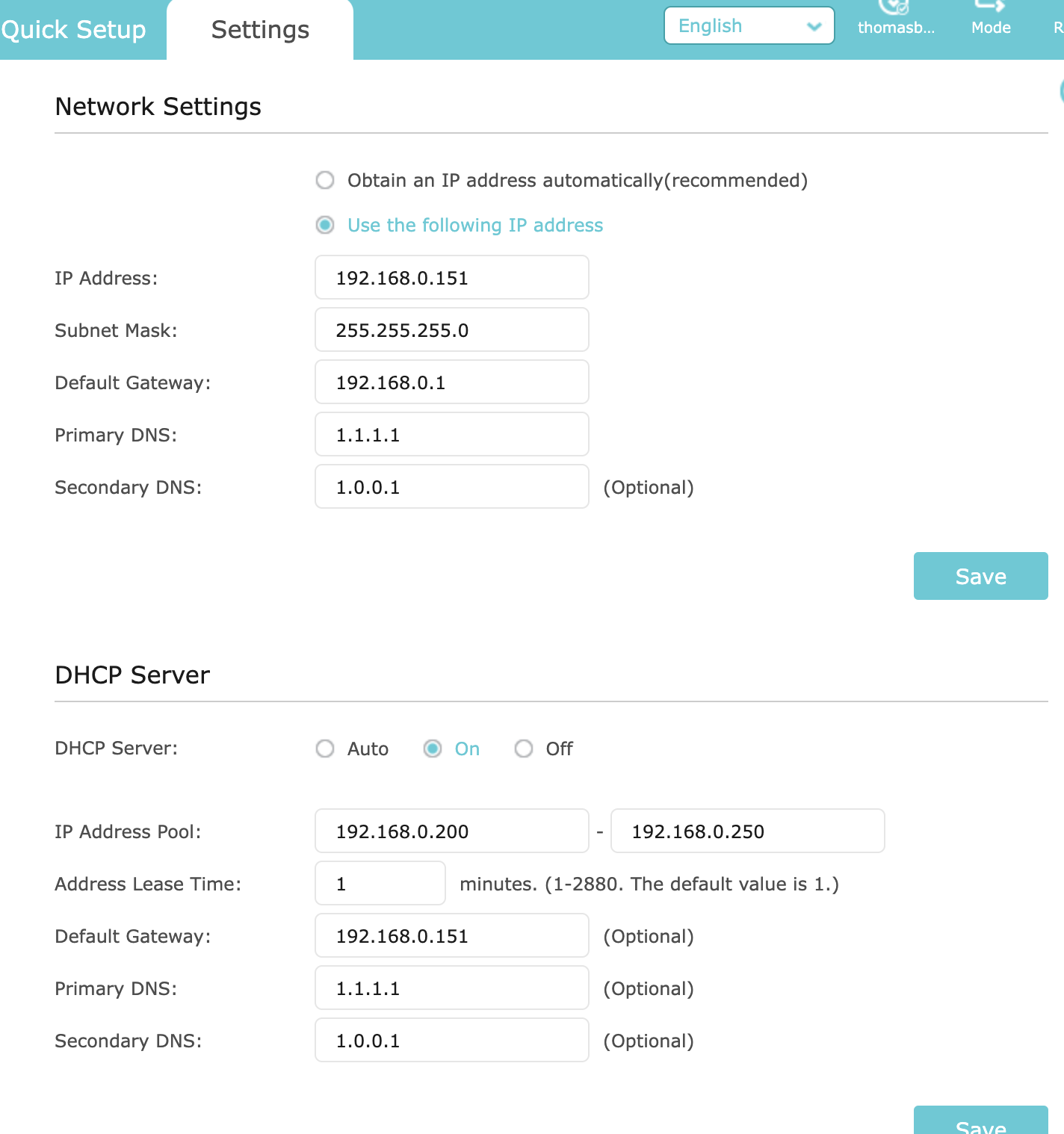

The ip address (192.168.0.151.) configured in the access point above is problematic because it is part of the pool currently configured to be used by DHCP.

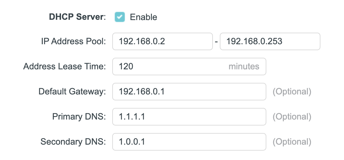

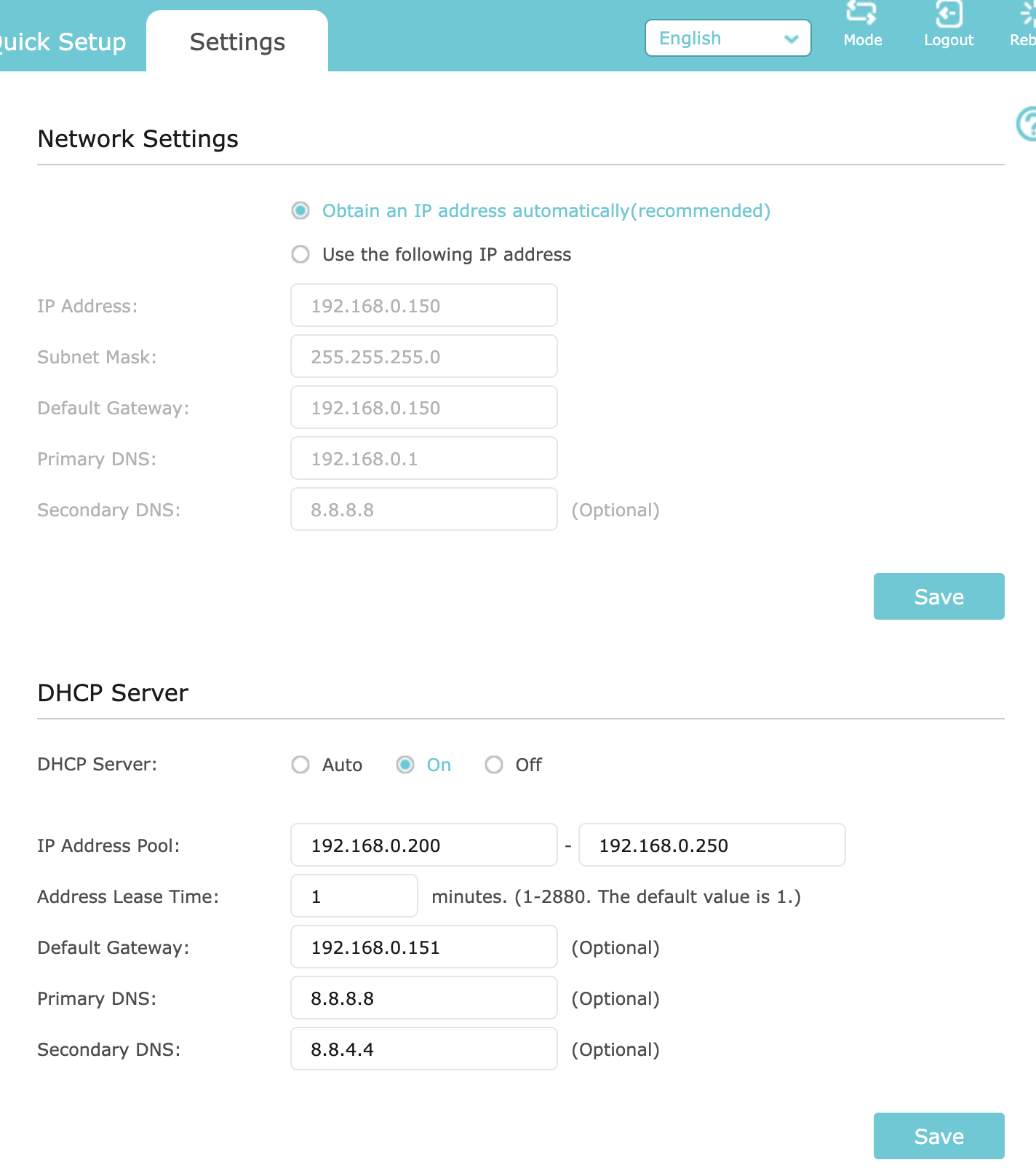

thanks for taking time to explain. I must admit , not being too tech savvy, I had a hard time following all of that info but have had a go at changing the settings which you can see here. Pls tell me if you see any errors. If you see things I can change specifically pls let me know .
also I am using 8.8.8.8 not 1.1.1.1 right now.

ROUTER SETTINGS-
INTERNET:
DHCP:
ACCESS POINT DNS:
OK. I believe your Router settings look fine.
However, on your access point, I would disable DHCP so that your primary router is the only DHCP server on your network. This keeps things far simpler. E.g.:
As it stands, you could, in principle, have issues because both your primary router and your access point have active DHCP servers which can allocate ip addresses in the range 192.168.0.200 to 192.168.0.250 and may, as a consequence get multiple devices allocated the same ip address.
You may well be getting away with it at present because, when a device uses DHCP to request an IP address, it will get two offers - one from the router with a 120 minute lease time and one from the access point with a 1 minute lease time. It is almost certain that the device would then accept the offer with the longest lease time - so effectively, you are only getting ip addresses from the router makeing the access point DHCP server totally redundant.

The other thing that I would do is to change the DHCP lease time from 120 minutes to 1440 minutes (24 hours). This means that, instead of requesting a DHCP address renewal after 1 hour (half of the lease time), it will only have to request a DHCP address renewal every 12 hours (720 minutes - again half the lease time). This mean that there will be a greater chance that ip addresses on your network will be stable.
Many thanks for your help. Question in the AP DHCP secondary DNS settings it’s now 8.8.4.4, should it be 8.8.8.8 or it no longer matters since it’s ‘off’?

DHCP DNS settings on the access point don’t matter if DHCP on the access point is turned off.
