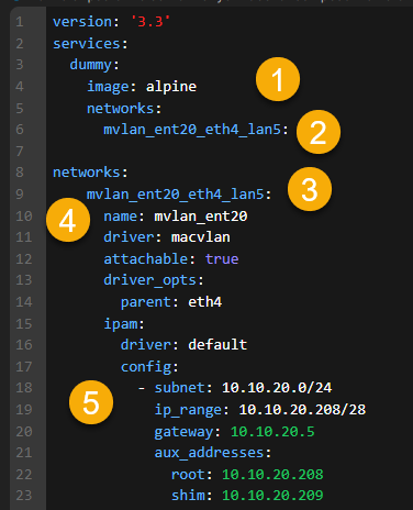

All, to create the macvlan via COMPOSE, you just fake out docker that you are creating a new docker image (that never starts) and build an external network definition in that compose file. (Why docker compose doesnt have the option to just build the network is beyond me) --also, this was not my idea, I got it from “the inter-webs” ![]()
here is my compose file to create the network and not have to use SSH (I see pasting below removes the indents - which are paramount for compose - see the image below for correct indenting):

here are some details:
- I just use a dummy alpine image - it will never run
2.this is the logical name of the network as defined below (mine tells me the ethernet port on my nas) - in the network section, you get to give it a nice friendly NAME
- as Sven has stated, this is all the magic - the full subnet this is on (/24), the range the macvlan will assign out (its like its own mini-dhcp in this range), the gateway, then you can reserve IP addresses in the aux_addresses section - the shim for me is for future use IF I want the host to be able to get into the image… lots on the internet about that - roon and rheos do not need this.
- note the PARENT tag - this is the ethernet port on your NAS you want to dedicate to.
- Sven and I set the network switch’s port to the vlan and do NOT tell the nas that the port is part of a vlan -
LASTLY, without the static routes being defined on the NAS, you will get odd behavior of traffic as docker and synology love to “help” here… - the static routes ensure all traffic flows correctly.
BTW, there is a GREAT side-effect of this setup (both Sven’s SSH and this compose file) - you can SET the IP address of the roon and rheos image in their compose files instead of having the macvlan auto assign…
here is a snippet from my Roon compose file:
- note the networks section and reference to the friendly name, then the IP4_ADDRESS section, lastly the “networks” section is where this compose connects to the external network you created via SSH or my compose (or similar). Now I know roon will always be 210 and rheos is always 211 and my plex is always 212 etc…

The only other thing that I’m not clear about is where you’re getting mvlan_ent20_eth4_lan5 from. Is that just your logical name or something else? Bear in mind that I’m using QNAP and not Synology.

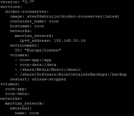

The only thing I had to to differently from Sven’s instructions is add an external flag into my docker compose in the network section at the bottom, otherwise it tried to create the network itself when I started it, so mine looks like this

- the dummy compose is run only once - never to be used again (unless I want to destroy and re-create the network slightly differently)
- you have to use the external flag so the network is exposed to the other dockers to connect to
- the weird internal name “mvlan_ent20_eth4_lan5” is just my name - you can use whatever you want – this lets me know its on my lan5 which is the 4th nic card in my device (and its a macvlan on my entertainment vlan 20 )
