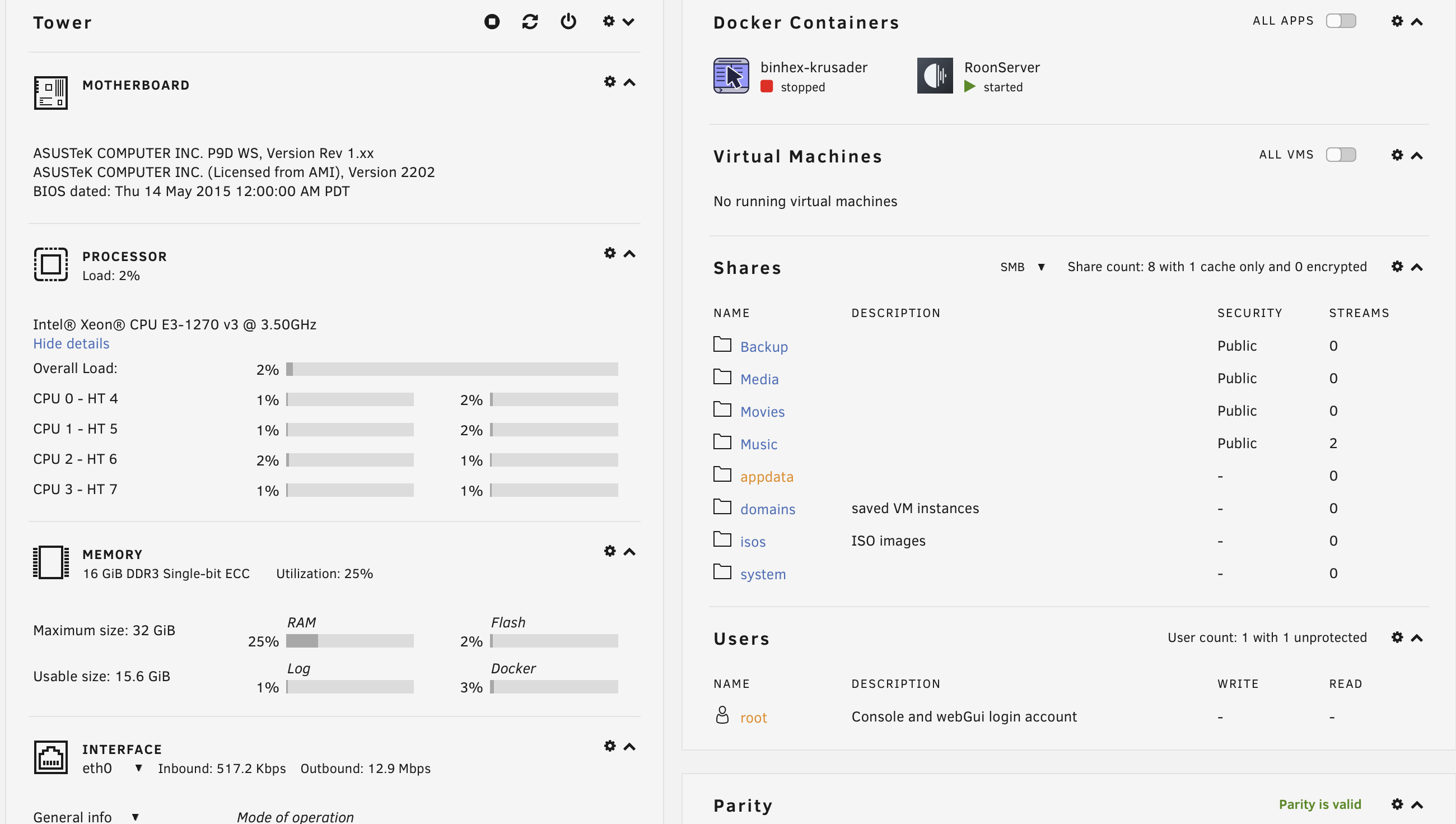

The docker container is not the problem, neither your CPU. Depending on how many VMs and docker apps you are running, 16GB of RAM maybe insufficient. You will need to isolate the problem. Disable all VMs and other containers. Once you do that, try to use Roon and see if you still have the same problem.
Sometimes docker apps misbehave when docker size reaches allocated capacity. I have seen also problems with apps after upgrades. It is mostly due to developer’s errors. It happens. You may want too also run plugin Fix Common Errors. That kind of skipping is most likely due to container competing for resources. The last step would be to delete container and RoonServer image and start from scratch. You could leave all the settings in appdata folder. If there is no improvement, delete that to and do clean install.

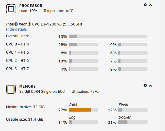

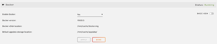

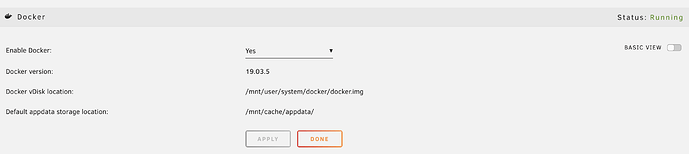

Your server is powerful enough to play multiple video and audio files at the same time. I don’t think Roon docker is the culprit. You could try to delete main Docker image in settings. Restart server. I noticed that initaly your appdata and docker.img file were located in /mnt/user directory.
Both appdata and docker.img should be located on separate SSD cache drive.

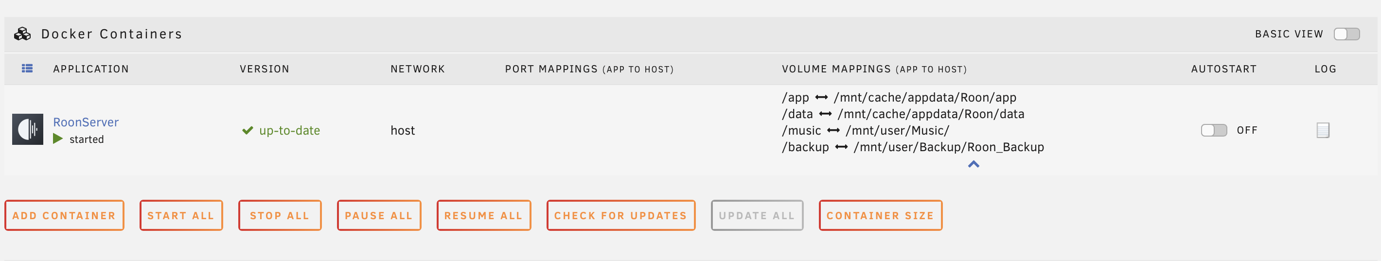

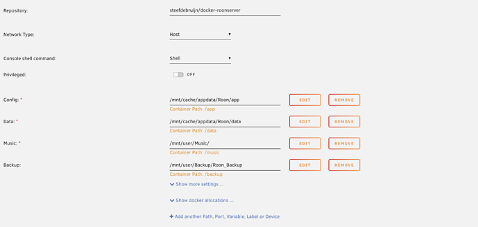

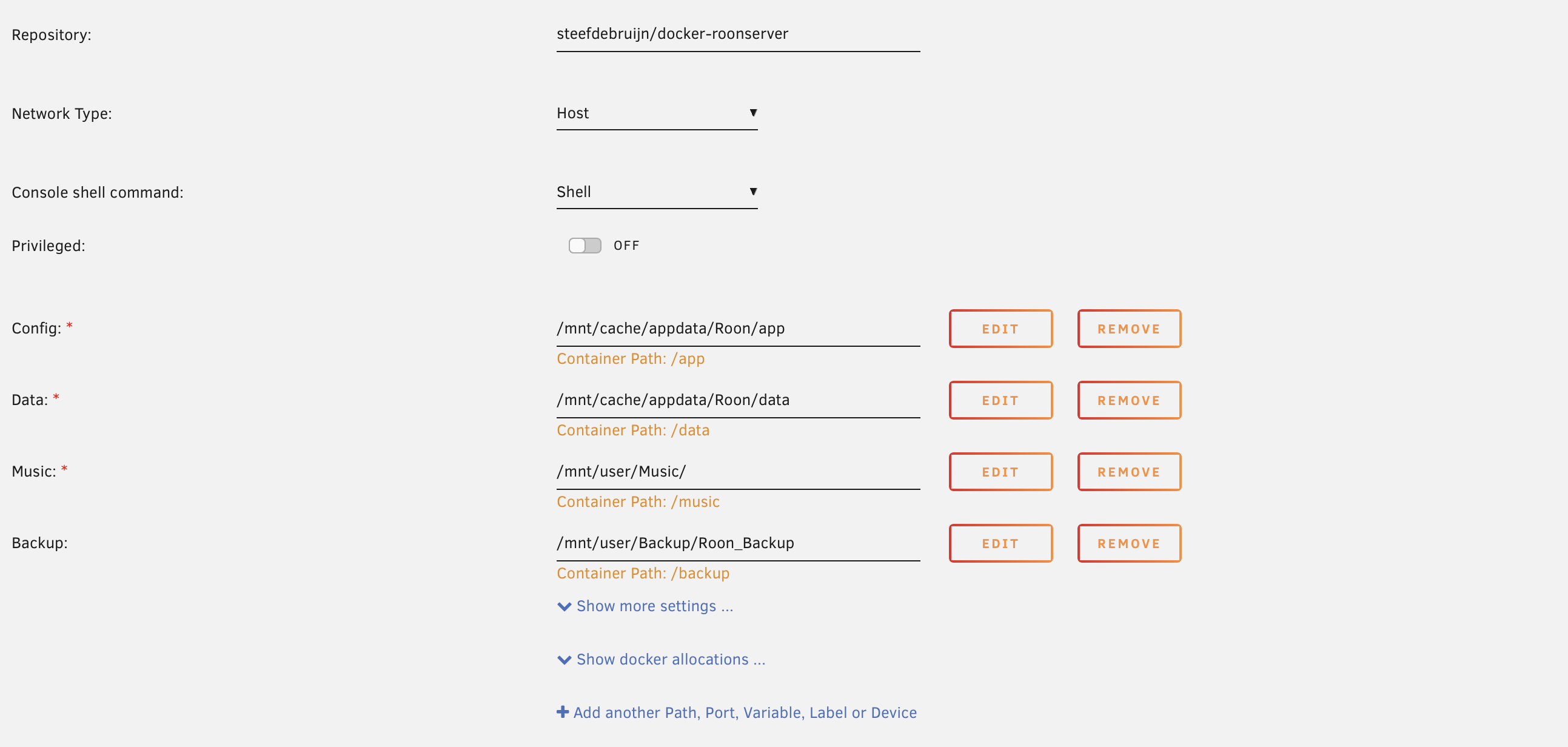

Also you separated /app and /data into two different directories. Let RoonServer manage it, so both /app and /data should point to the same location
/mnt/cache/appdata/roonserver/
Ah, I’m now very confused as I got different advice regarding the configuration This is currently how it is set. The library is on the Unraid and the Roon server is in the docker. It distributes to a Mac mini with the Stereo connected via USB to DAC. I control using Roon on iPad.

That’s Nucleus+ / mobile i7 territory, and explains the ram usage

I understand your concerns about paths, but we really do not know internal workings of this application. These paths are only a gateway to outside environment

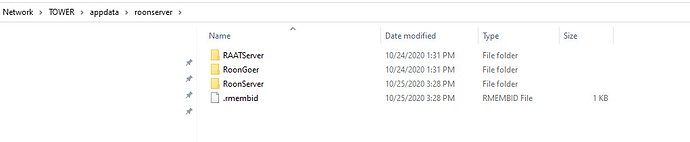

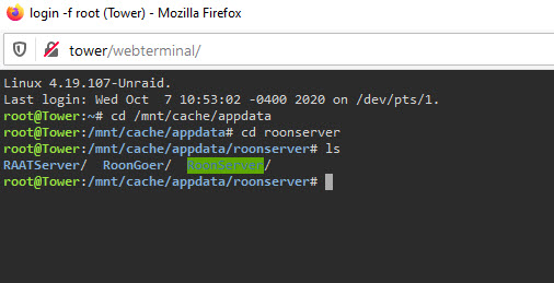

As you see from this picture, there are no separate /app & /data folders
And there are no hidden folders either

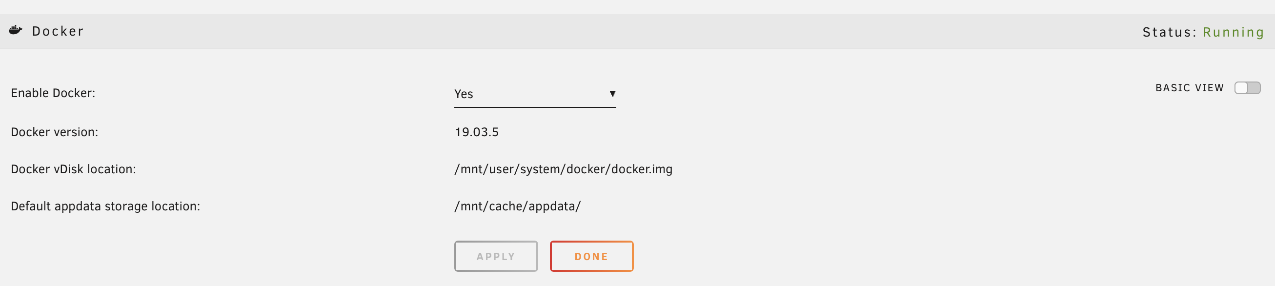

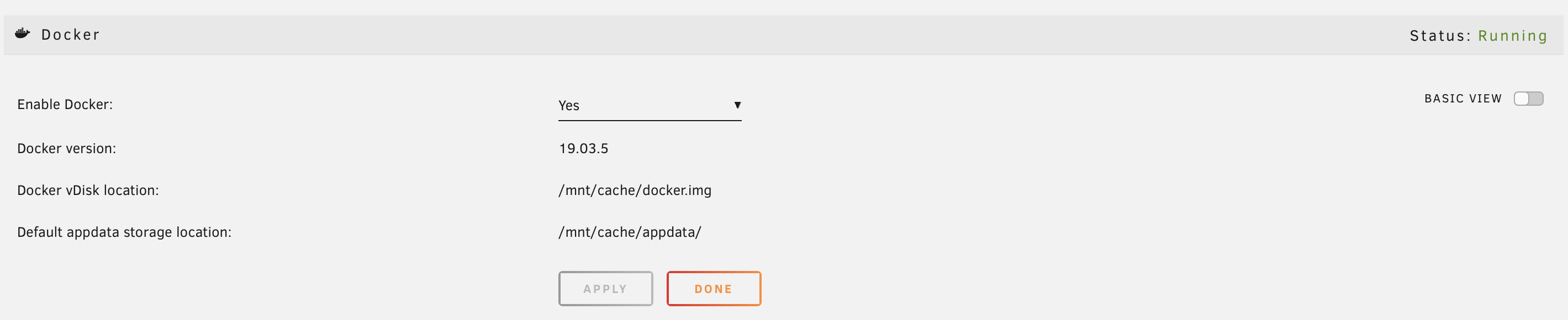

Move main docker image to your existing SSD. Create folder to store file.
Go to settings/docker
Since you have only 2 containers running, the docker image can be small 20Gb or less.

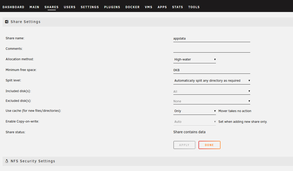

On more thing. Sometimes content of some folders may exist in two different locations: cache & array. You need to ensure that whatever exist in appdata is not copied to array. Use Krusader to see if you have folder named appdata under /mnt/user/appdata. It should be only /mnt/cache/appdata
The /app
folder inside the container contains one folder: RoonServer
# docker exec roon.service ls -l /app
total 2
drwxrwxrwx 5 1000 1000 8 Oct 20 18:00 RoonServer
The /data
folder inside the container contains three folders including RoonServer
# docker exec roon.service ls -l /data
total 3
drwxr-xr-x 5 root root 5 Jun 18 09:53 RAATServer
drwxr-xr-x 3 root root 3 Oct 18 2017 RoonGoer
drwxr-xr-x 7 root root 7 Oct 20 18:00 RoonServer
See the potential problem here? On your host those two RoonServer
subfolders have their contents mixed up.

No there are two totally separate RoonServer
folders.
The /app
one contains the app which is downloaded on first run by the container. It’s contents is managed by the container startup script on first run and by the core updater after that.
The data
one is created and managed by the Roon core and contains the Roon database and other files needed by the core.
There are two different folder exports for a reason. Do not maps those two on one and the same host folder.
