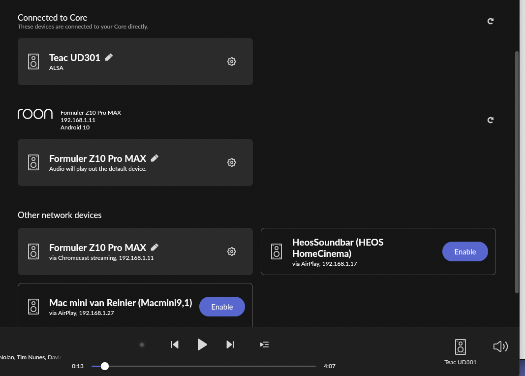

This appears to be what Tecko71 has:
If that’s the case, it isn’t Android TV. At least not according to the specs:
Operating System : Android 10
This wouldn’t be the first TV box to use the phone version of Android instead of the TV version.
That squeezebox option works. I installed sbplayer on z10 from the store.
Now there is a Chromecast showing up (how comes?) but giving that zone the same name as the Roon (RAAT) zone is probably not helpful.
grafik
Anyway, the OS on this set-top box is likely heavily modified, so nothing has to work as expected or at all.
