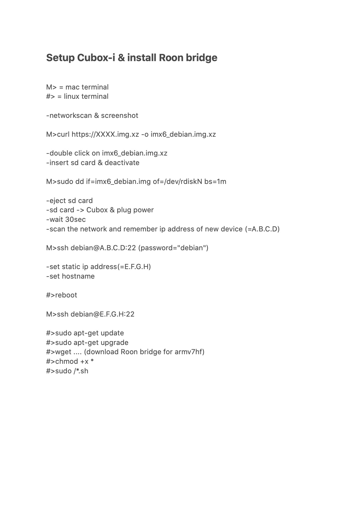

I did the setup and the “new” device is now playing radio for me. :slight_smile:
I’ve written down the steps roughly. Please take a look, if this would be possible to realize for you.

That looks awesome! Thanks bro. I’ll buy today. Yes, I have a Macbook Air. 24/96 should be just dandy
